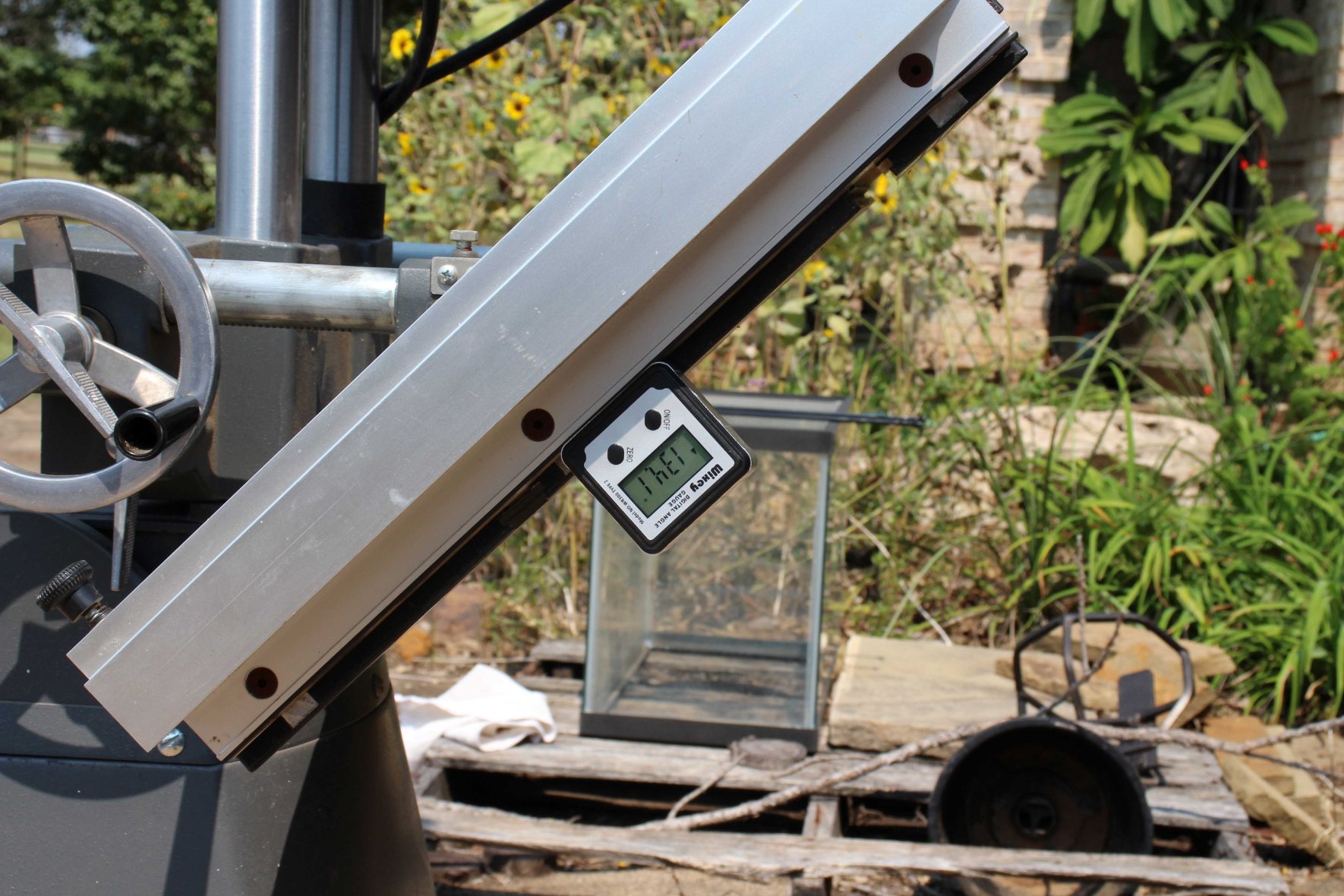

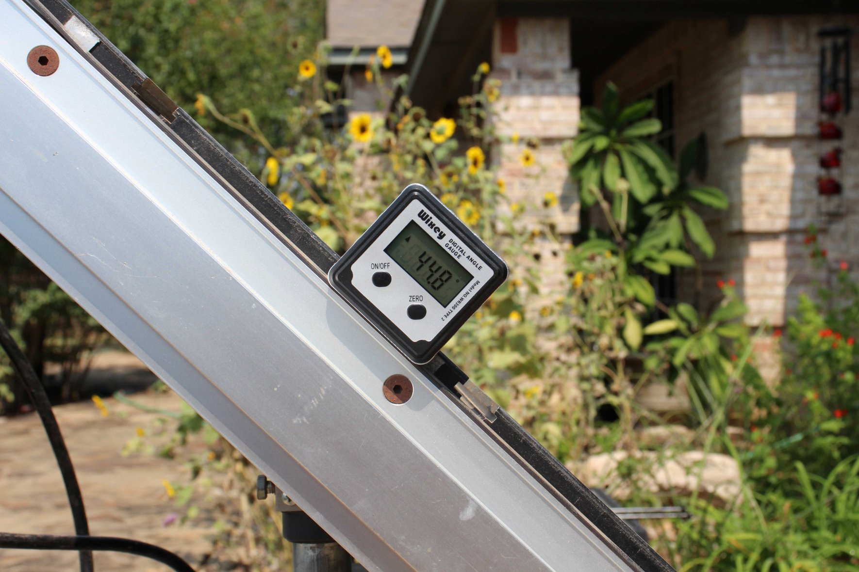

Make me a believer! Post a picture of a Wixey that was zeroed on the horizontal and then rotated to 135 degrees.
DLB
Posts: 2307
Location: Joshua Texas
Re: Shorty Drill Press not perpendicular to floor, any ideas?
Post by DLB »
dusty wrote: Sun Sep 12, 2021 2:34 pm Make me a believer! Post a picture of a Wixey that was zeroed on the horizontal and then rotated to 135 degrees.
Ref 45.JPG (287.87 KiB) Viewed 1021 times
Ref 135.JPG (328.46 KiB) Viewed 1021 times
I'll have to go look at your other thread. I take it that the angle cube does something else.
- David
