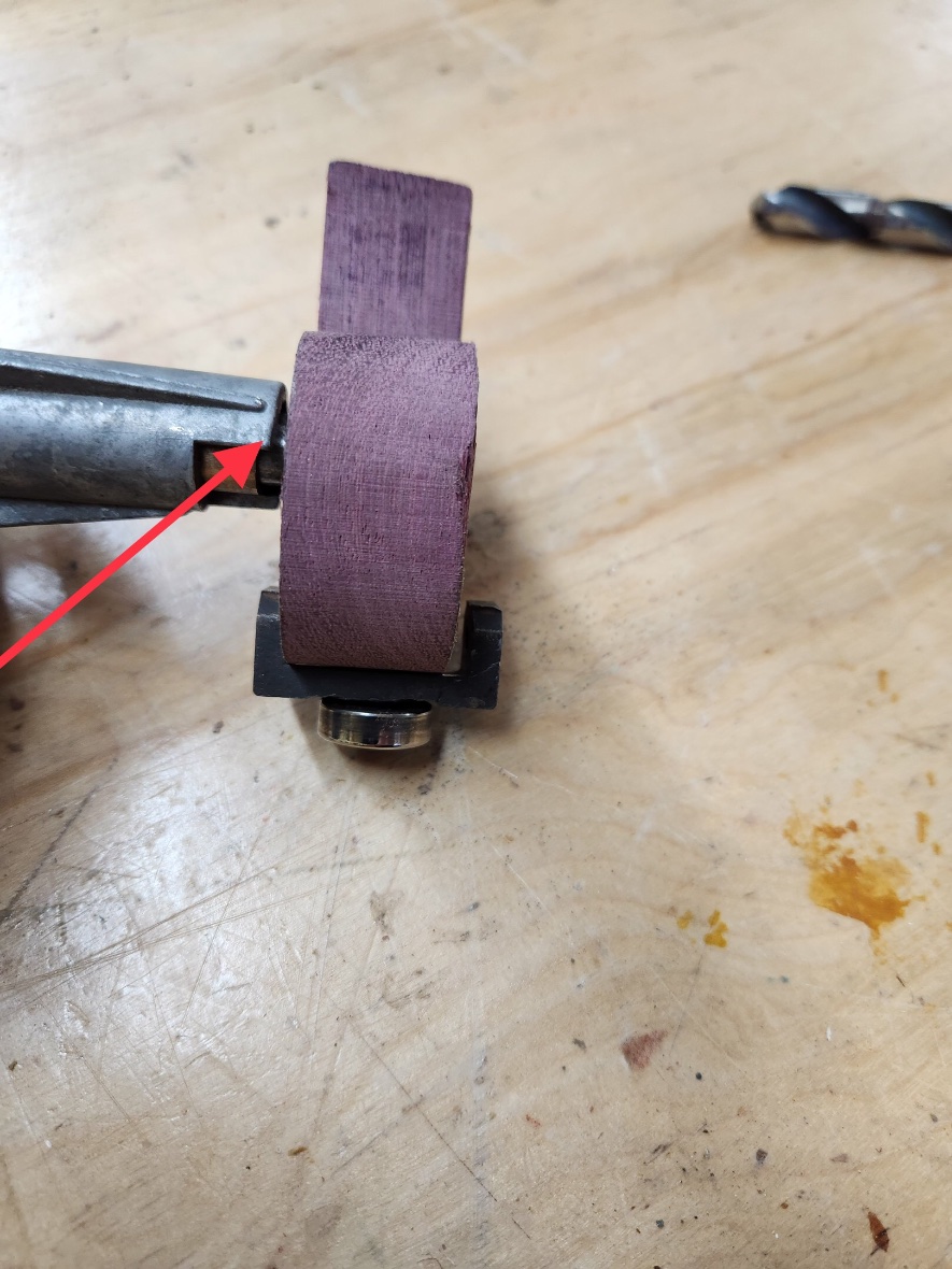

FWIW turning that dial does require substantial torque at even mid speeds(runaway high speed positions excepted!!!).
- shipwright
- Posts: 1165
Re: Mark VII “Project Machine”
I have shimmed carefully to be tight enough not to run away at the high end while keeping my cam centered in the follower. It works well.
Shimmed what? Detent thingies???
- shipwright
- Posts: 1165
Thin shims under the circlip that holds the control disc on will tighten the detents. In my case I need to centre the cam as well so thin shims where the arrow is in the picture will adjust the position of the cam in the follower while adjusting the detents at the same time. When you get the balance it works great.
With a standard cam just under the circlip should tighten the detents.

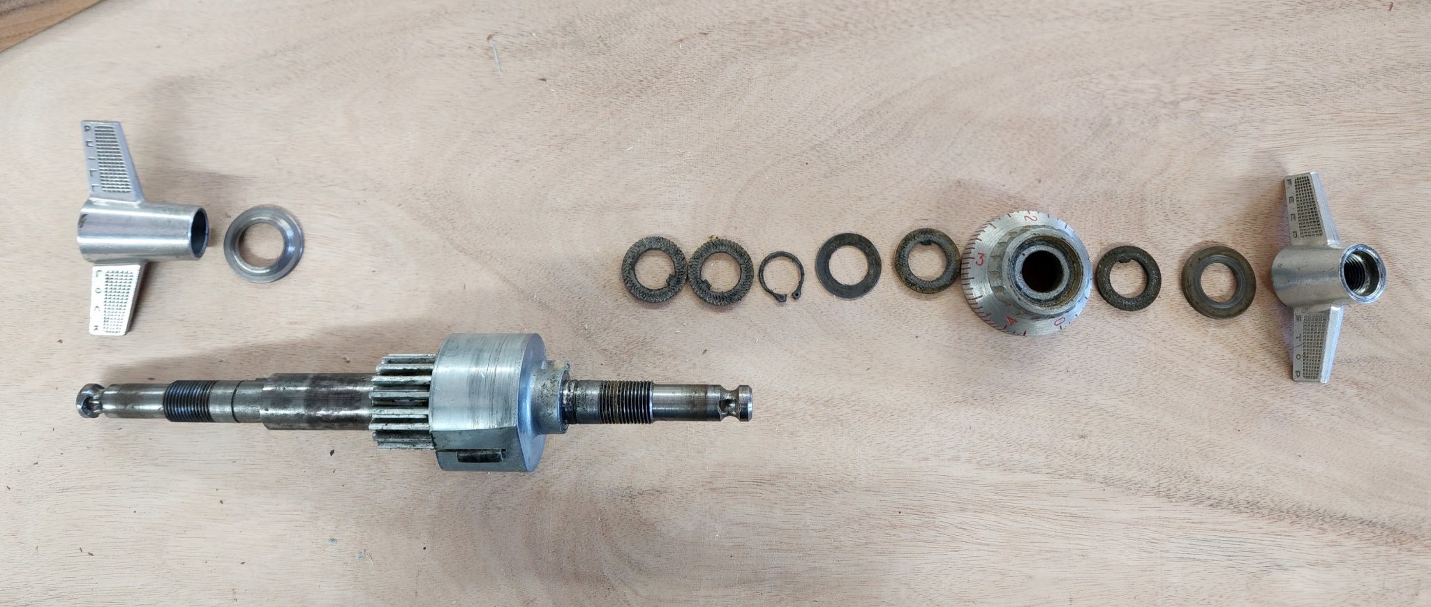

This is for JPG.
Back on page 8 of this thread we were discussing what I might find inside the headstock of the greenie on the quill advance shaft. Well I got into it yesterday while replacing the gilmer belt. It was interesting. There were no washers at all inside, way too many on the spring side, and the cup washer under the quill brake. It actually kind of worked if you cranked the brake hard enough. The last picture is the “extras” for the spares drawer.
