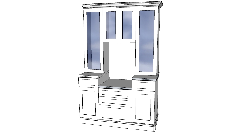

Gettin better
I am slowly improving my drawing skills. This display cabinet sets to the right of the entertainment center that I posted last week.
[ATTACH]5991[/ATTACH]

Ahh Grasshopper, very good...
Now we've got something to work with.
It's tough to judge, but I would suggest that the pillar and corresponding filler below be raised panel, if they are large enough. The break in symmetry(sp?) doesn't look right.
Also, the video cabinet doors should be of either a black or frosted glass to kind of match up everything if the rails and styles are strong enough to support that.
That's my 2 cents worth, for what it's worth.

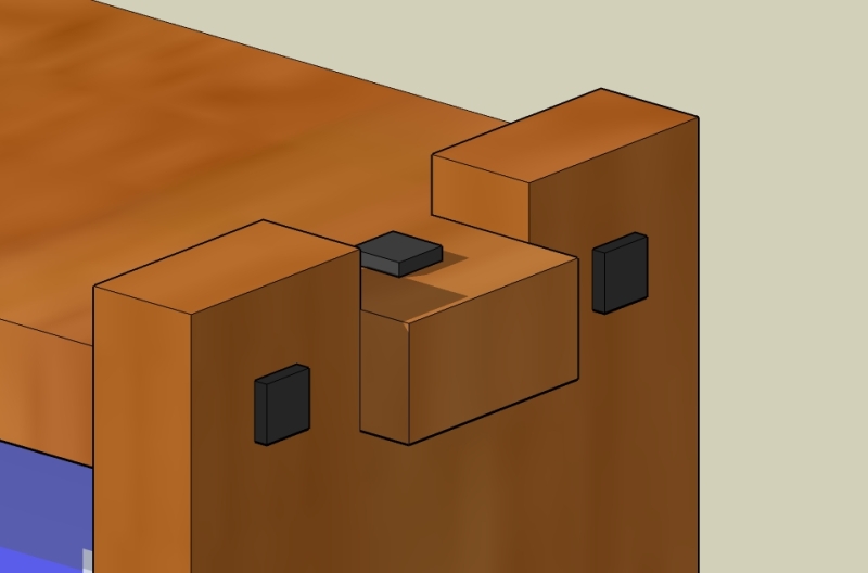

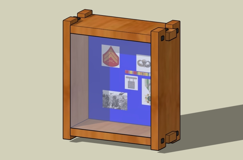

Using what I've learned so far, I put together a rough model of the display case I'm going to build for my dad's Marine Corps medals. Dimensions are just a guestimate at this stage. I haven't yet collected everything and laid it all out to see what size the box needs to be.
[ATTACH]6686[/ATTACH]
Although I showed the glass front, I didn't show how it would actually be installed. The plan is to install it like a drawer bottom with the glass fitting in a saw kerf in all 4 sides.
One thing I couldn't figure out how to do was to round over the edges of the fingers and the square plugs. Using the "Follow Me" tool resulted in some really weird things happening.
[ATTACH]6687[/ATTACH]

I found those images on the web, saved them to my computer, then in Sketchup went to File -> Import and loaded them into the drawing. I could have taken more time and edited the images to have a transparent background instead of a white background, but I was getting pretty tired at that point last night.mbcabinetmaker wrote:Heath I am impressed! How did you get the pictures and medals into the drawing?
