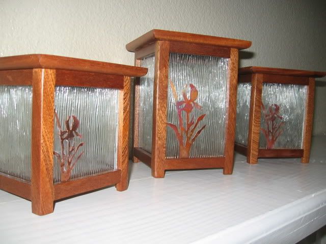

judaspre1982 wrote:Is it that the rail on that side goes thru the stile as opposed to against it? The other side in the previous pic looks like the rails butt up against the stiles.----Dave

WINNER WINNER CHICKEN DINNER!!
Yep, that's it!
The joinery between the rails and stiles are half lap. So on one side of each lantern side you'd have the rail part of the joint exposed. On the other side you'd have the stile part of the joint exposed. A saw kerf is cut into those lower rails to receive the rabbeted edge of the base in the center.
I used a jig to hold each side as I ran it over the table saw blade to cut the kerf. This made sure the kerf was in the same position on each one so they would all line up when assembled. (Also kept the piece secure and my hands out of danger since there was very little to hold on to.) On that one side, somehow I put it in the jig upside down and cut the kerf on what was supposed to be the outside instead of the inside.
After "losing my religion" as Nick would say, and evaluating if I wanted to completely rebuild that side or not, I decided not and just went with it.

Nice work Heath. You adapted to the conditions at hand to salvage the materials. That is a talent in itself. Way to stick with it.

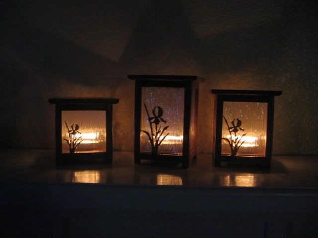

Lanterns are finally done!
Bad pictures, but here they are:
This was a fun project and it taught me a lot, but it took WAY too long. Hope mom likes with them.
