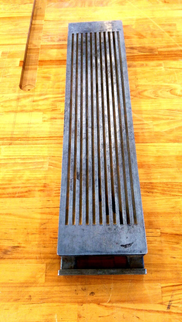

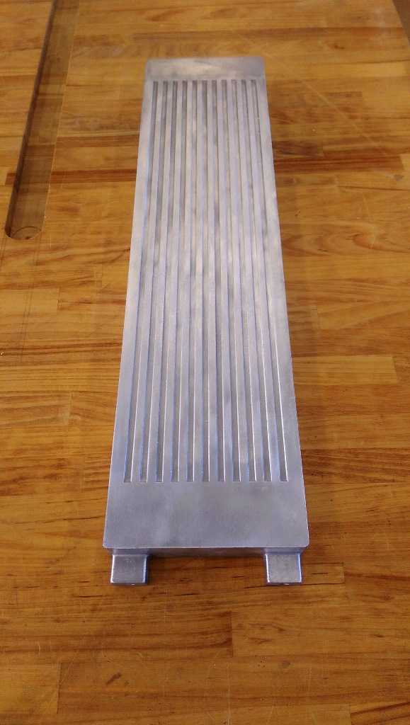

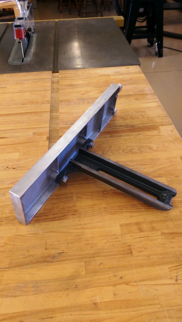

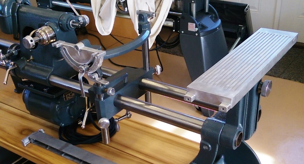

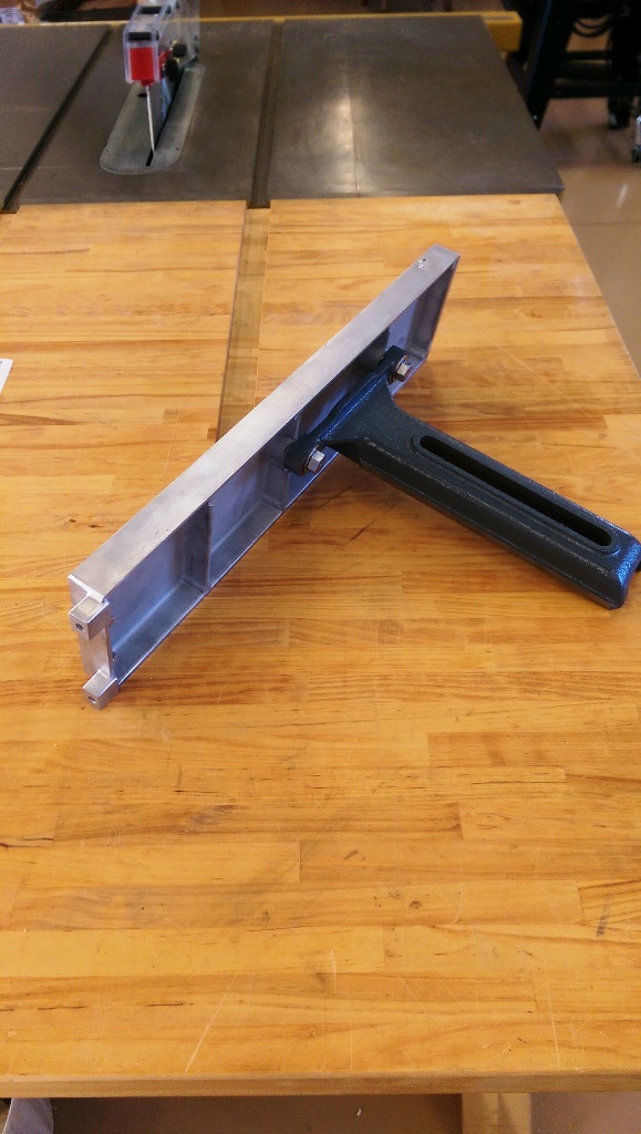

I am getting closer. Got the aux table top done today except for the fence rail. It is soaking in Evaporust. So the only thing left is the main table top and it's fence rail.
ERLover
Posts: 3914
Re: Restoring 10ER S/N 83974
Post by ERLover »
Spit and polished :)

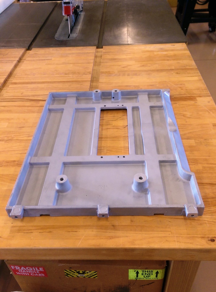

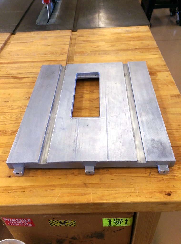

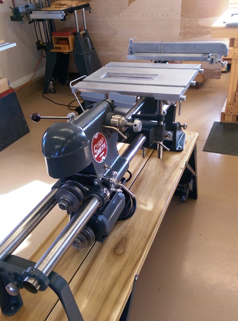

Almost there. I got the main table top almost done. I want to work on the top surface a little more. I also need to get a piece of PVC pipe to soak the fence bar in Evaporust. I also just realized I don't have a blade guard. I know I have a couple with the other machines in the garage. I will use one of them for this machine and see how many I am missing. They come up on eBay all the time.
ERLover
Posts: 3914
Post by ERLover »
Like a new penny!!!

BuckeyeDennis wrote:I use Nyalox wheel brushes chucked up in my Shopsmith for most such chores. They come in three different "grits", from fine/gentle to moderately aggressive, and I have found each to be useful. Vastly superior to wire wheels, IMHO.
I used one a while back to test clean/polish a section of 10ER table, and that test section went just fine.
I finally got some Naylox wheels and cup brushes in the shop. I used them on the table after glass blasting it. They work very well and I think I like them better than wire. I did the top of the table with a RO sander with a 320 grit SS ceramic disk. That worked well. The issue is still the best way to get the black residue completely off the table. Since I did not use any polishing compound maybe a good scrub with soap and water will do it.
