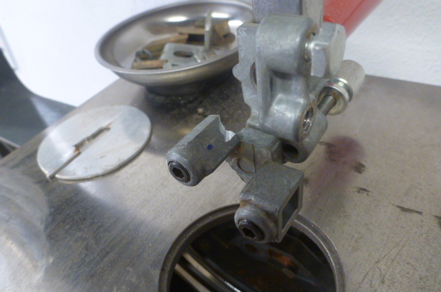

2-3 hrs later, got some cool guides in, the new bearings (think I did this right??). Waiting for the new tires to come in from polytech (think I ordered the right one??). BTW, dirt dobbers are lame... Then it's off to alignment. All uncharted waters over here - first bandsaw ever.

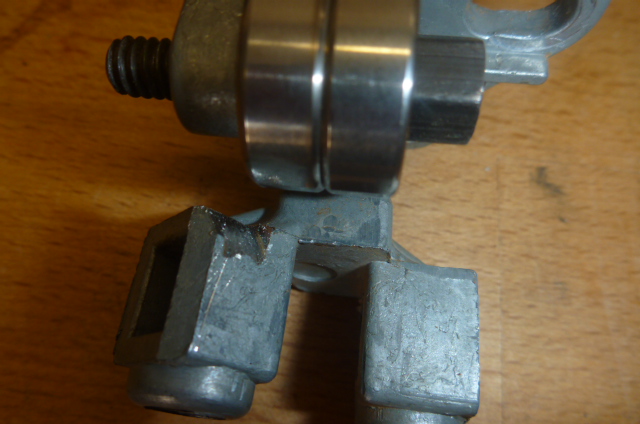

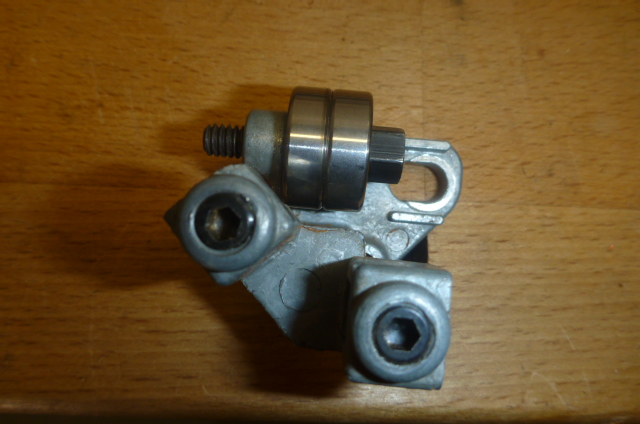

In preparing for a trip to Ace for 7mm bolts I took the time to attempt to test fit two 627 bearings into the upper and lower guides using the factory 1/4" bolt with 7mm step.
After filing the upper and lower guide brackets to clear the double 627 bearing set-up I noticed everything spins freely and the seam between the two bearings is nicely line up in the middle right where the blade will track. I am going to run the double bearing set-up this way and see how it goes. I can always change over to 7mm bolts and thin shims between the guide bracket and the guide bearings if needed.
Not sure why I would need all the extra shimming and spacing that was all the rage 4-5 years ago.
If you're worried the double bearing on the factory bolt with 7mm step doesn't have enough support from the 7mm step, notice the factory set up for the accutrack double bearing uses the exact same length stepped bolt as the upper/lower bearing guides. When the factory stepped bolt is used on the upper/lower bearing guides those upper/lower double bearings have the same support as the accutrack bearing set-up.

Tires are on. Got everything cleaned up and have the post arm bracket pulled to be drilled and tapped. Where exactly should a 3/8” blade ride on the wheels? Centered? Towards the back? How much should the blade be riding on the bearings?
