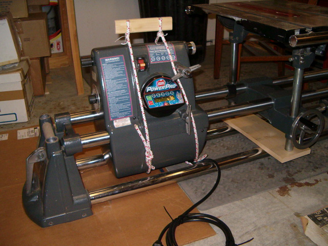

Having trouble lifting the PowerPro down or up to the way tubes was a problem for me. Also fitting the headstock into the padded box for shipping.
I made a simple cradle sling - It helped immensely!!! No need to lift on the spindle/
PowerPro Sling.jpg (130.38 KiB) Viewed 5270 times

charlese wrote:Having trouble lifting the PowerPro down or up to the way tubes was a problem for me. Also fitting the headstock into the padded box for shipping.
This grip isn't so much the issue although I do like that sling. After back surgery, I just can't lift 80lbs safely any more. I've achieved old fart status! :D
Wasn't sure if it was safe to extend quill and lift on it but that's a great idea too!
Thanks!
Tom
Making scrap wood with style!
