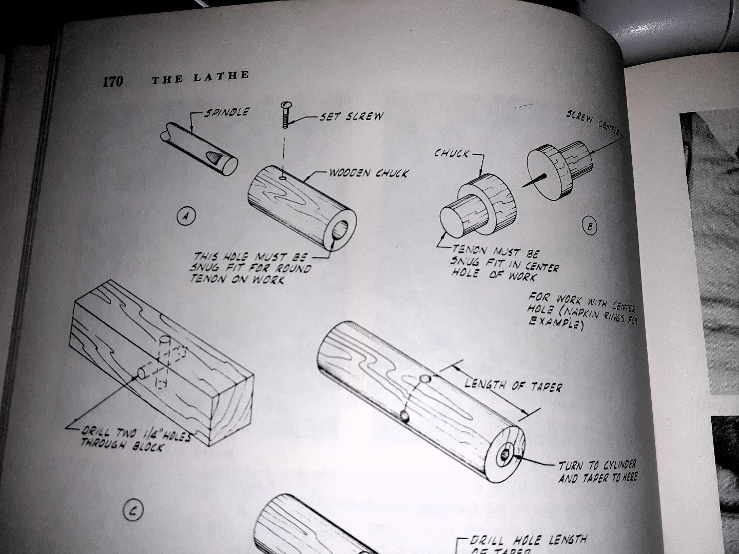

What type of center would you recommend for making thinks like wooden fids and thimbles? I can post pics if y’all aren’t familiar with those...the fids are basically wooden spikes used to splice rope and the thimbles are small ferrules used in nautical rigging...
From the pictures these look to be basic spindle turnings, and I suspect you will want to do a batch of the thimbles. A scroll chuck is not necessarily the best tool for the job. :)
There is a good section on lathe turning using the 10E/ER in the first edition of Power Tool Woodworking for Everyone.
A digital copy that has been restored and enhanced by Everett Davis, is available on line.
in the link, on the first post click on the red "My Google Drive" , click on the folder PTWFE 10ER 1953
viewtopic.php?f=10&t=16113
Here is a youtube video on turning a fid, He has used a chuck, but it could be done between centers. The final cut on the handle end would need to be sawed off.
[youtube]https://www.youtube.com/watch?v=Z11C9a8z5TE[/youtube]
For the thimbles, i would suggest boring the hole first in a length of wood, then turning between a drive center and a live center with a cone end on the tailstock. You should be able to turn and part off a few thimbles from each blank.
Then make a jam chuck (just a piece of scrap wood that has been turned the bore of the thimble with fit snugly on it) it could be fitted on a face plate, or mounted on a screw center (B ) or mounted directly on the spindle (A) for finishing.

And I’m not trying to make a captive ring or just any old random “ring-shaped” piece of wood — I’m trying to make (exactly) the wood thimbles I posted pictures of...exactly as they look in the pics with interior and exterior radii cut/rounded over. I’ve searched incessantly for videos showing how to do that....how to actually HOLD the piece for doing the inner radiusing, and haven’t found any. Guess I’ll try the jam chuck thing. Hope it doesn’t fly out and shatter my faceshield.
