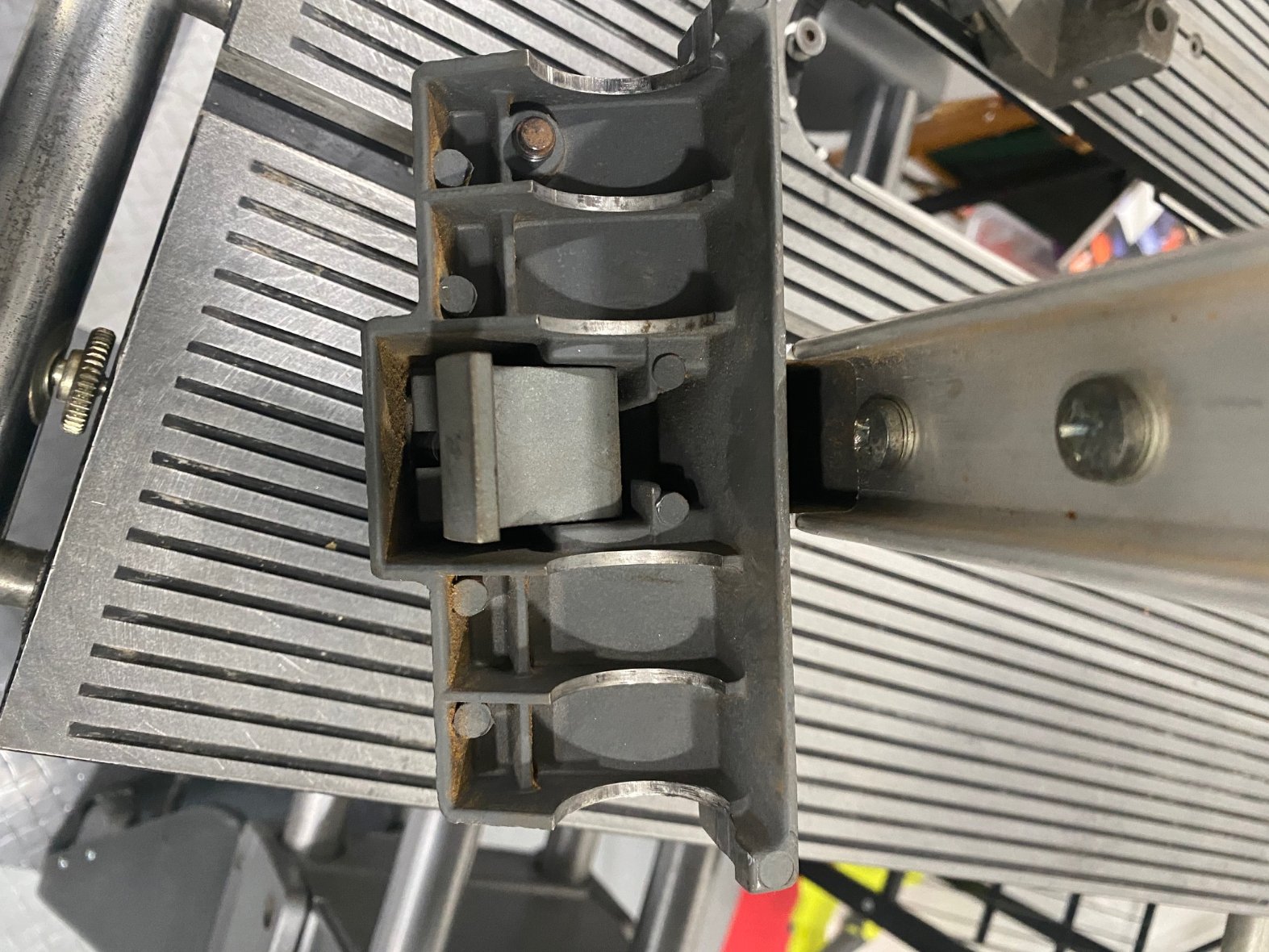

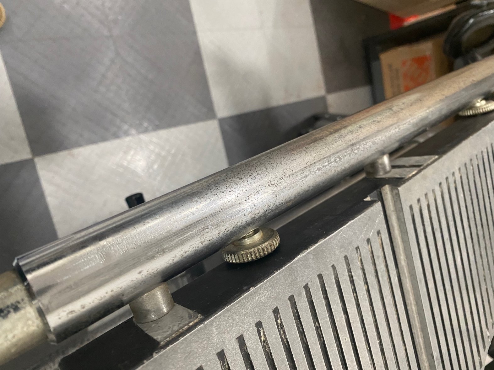

It continues to go back together. I've run into an issue with the fence, its hanging in the same spot to the right of the blade opening. I thought it might be the tube, so I swapped them front to back, but it still hangs. Its not hitting the table, so I'm stumped. I've linked a short video of the problem.

Any thoughts are appreciated.

- Posts: 35457
Re: Refurbishing a MkV 510
It appears to be hanging up near/over the miter gauge slot.
For starters, I would back out that confounded fence biasing screw until the inner end is flush. It appears in the upper left part of the 'head' in your second pix.
I noted it bound more when you first pushed it towards the blade slot. Pushing that direction causes the fence 'head' leading end to cock towards the tube.
The tubes may have greater c-c spacing at the hang point but that would imply insufficient rear clamp clearance.
I really think that setscrew is de culprit.
P.S. Another look revealed scratch marks on the head casting on opposite sides of the setscrew. The screw may have scored the tube when sliding off the end. Look for a burr on the ends of both tubes.
BTW glad that setscrew IS a flat point as it should be.
