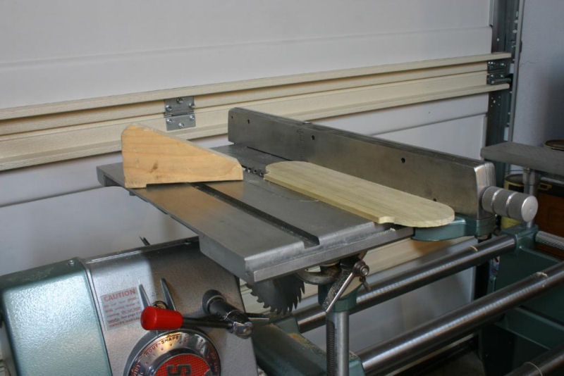

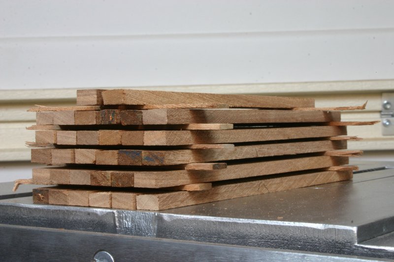

Finally, some significant sawdust off the Mark 5!!! Managed to get my 21 linear feet of 1/4" x 1/2" x 8" mahogany 'lumber' for the candle lanterns cut last night. Put a little fork lift on the side of this pile and you'd think the stuff was huge.
[ATTACH]7768[/ATTACH]

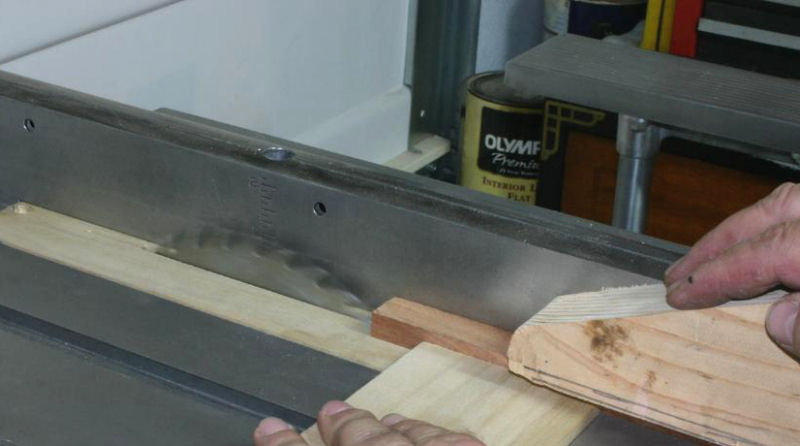

Because of the narrow width strips, I had to first make up a zero clearance insert. Found some .250"x4"x24" poplar at Home Depot. ($2.50). Traced the outline of the table insert onto it and cut it out on the jigsaw / table saw. I made up the ‘shoe’ style push stick suggested by shipwright prior to the table saw work.
[ATTACH]7769[/ATTACH]
This style push stick worked great. I felt real comfortable using it. Need to get in the habit of keeping three fingers on the other side of the fence as I pushed the stock through.
Based on the 'no cut' advise, I opted to not resaw the 4" width into 1/4" thicknesses. Instead, I cut strips. Since I only had 3 pieces of the 4"x8"x13/16" stock, I had to minimize waste by first ripping 1/2" wide full thickness strips then ripping the full thickness strip into the final 1/4" thickness, flipping the strip, and cutting the other side, leaving the center 1/8" as waste. Again, with the ‘shoe’ pushstick, very controllable. Notice my handheld featherboard alternative.
