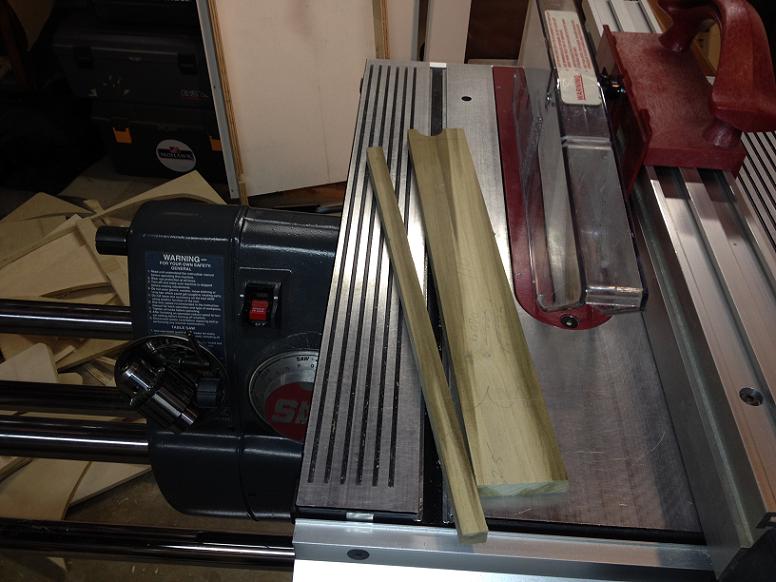

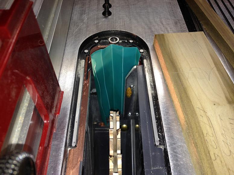

This morning I set up the dado blade to make a cut.
Here's a photo showing the dado blade in place and the insert removed to better show the accordion deflector.
[ATTACH]23213[/ATTACH]
The result of the test cut.
[ATTACH]23214[/ATTACH]
The result that counts.
[ATTACH]23216[/ATTACH]
I recorded a video, below the table, and posted it to YouTube. Here is the link: http://www.youtube.com/watch?v=Eq9yq1mKC88
I am very pleased with the result, especially as dado cuts usually leave large piles of fluffy chips all over the carriage.

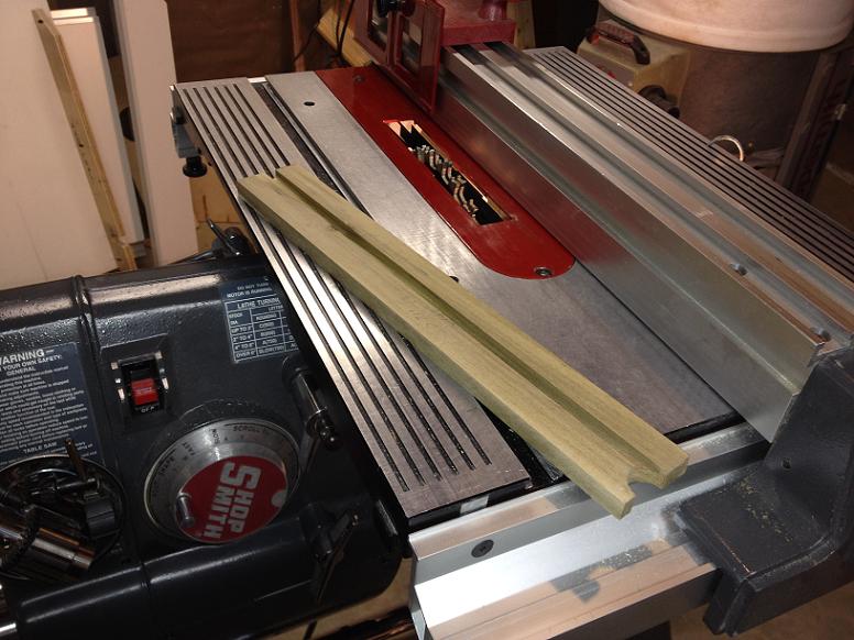

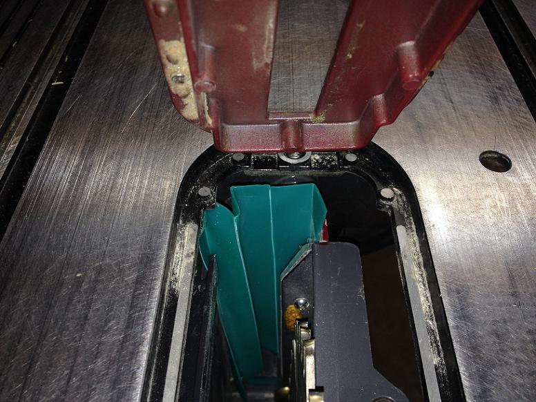

Of course I also tested a standard rip cut.
Photo with insert removed to better show deflector.
[ATTACH]23217[/ATTACH]
The result of the test rip.
[ATTACH]23218[/ATTACH]
The result that matters.
[ATTACH]23219[/ATTACH]

Very happy with this result!

Deflector looks good. Does the video expose the source of that which escapes?
I think it would be unreasonable to expect any better dust collection than that. Great job.
Now, if we could just do the same thing with the table tilted.:rolleyes:
Actually, I can. BUT, the effort required to do so is unreasonable. A more flexible deflector that does not interfere with the tilt AND does not interfere with the blade is required. I have not yet come up with that.
I knew that you would spot that, Eagle Eyes! That magnet is actually a magnetic parts dish from Harbor Freight. Can't remember whether it is the 4 inch one http://www.harborfreight.com/4-inch-mag ... 90566.html or 6 inch one. http://www.harborfreight.com/6-inch-mag ... 97825.html
I think the videos suggests that some dust is escaping the tie bar side and some from the front. I also suspect some from the headstock side. In short, everywhere. But less than without the deflector for sure.
