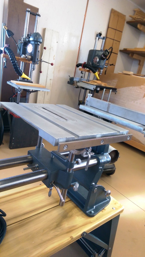

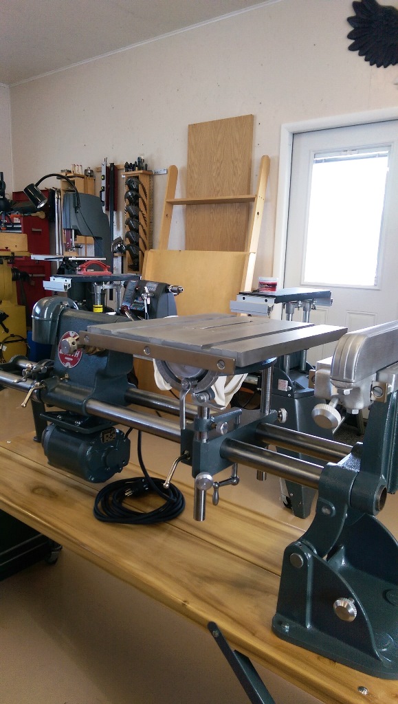

The main table is done after soaking the rip fence bar in Evaporust for two days. Then it was polished with 120 and 240 Naylox wheels. It looks almost new.
So almost there. The miter gauge, the miter gauge extension and upper saw guard need to be painted. Those are accessories so the basic machine is done.

I notice the fence rail looks brown in both pictures. It is certainly not brown but very nicely polished.
Posts: 3812
Re: Restoring 10ER S/N 83974
It looks to me as if the fence rail is simplying reflecting diffused light from the floor -- the sign of a good polishing job.
