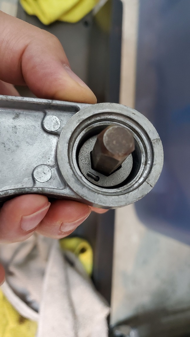

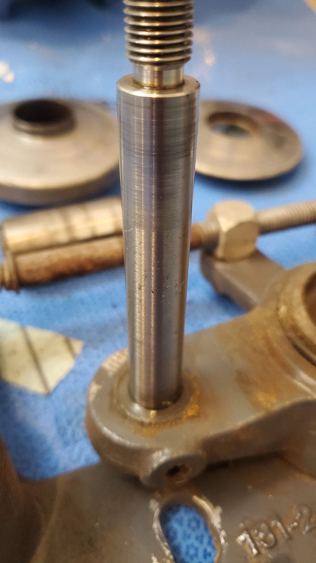

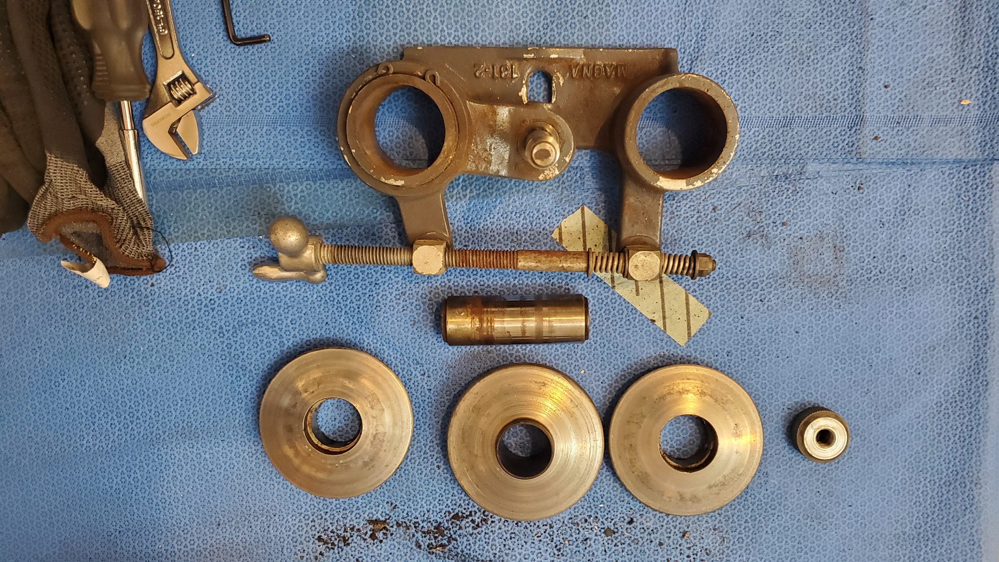

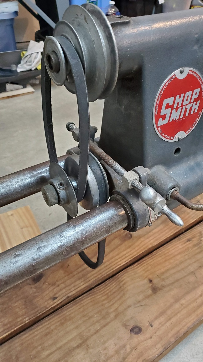

As for the picture John posted, the pulley end shaft having a "ring" is where the shaft leaves the housing and is subject to all "evil" things out in the world. To me the "ring" looks like rust and/or gunk.

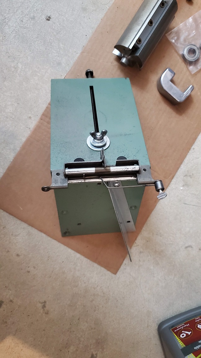

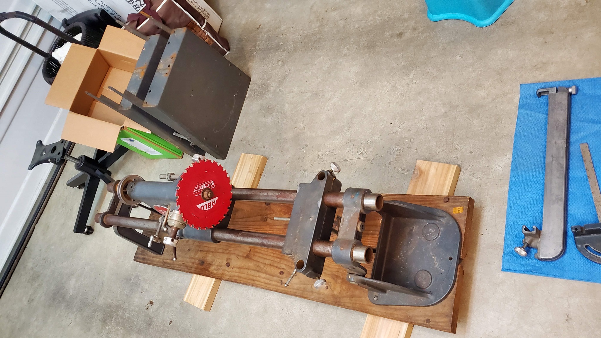

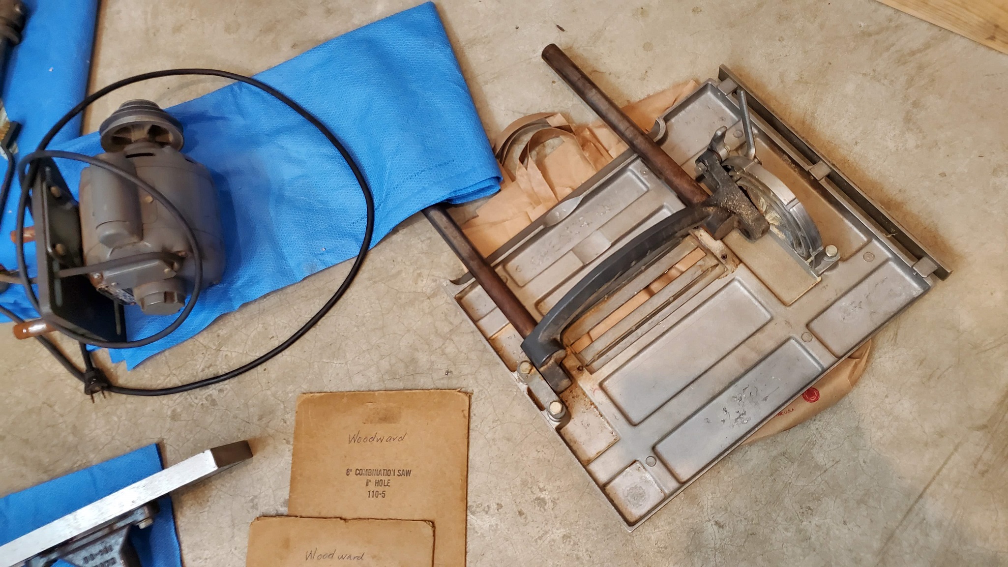

I finally got my order from SS yesterday after almost 2 weeks! Not sure why it took so long, but I now have everything I need to put the jointer back together. I ended up ordering the guard spring+washers to see if they were compatible with the older model. As far as I can tell they are the same parts? everything fit and I'm able to pre-load (torsion) the spring before installing on the jointer.

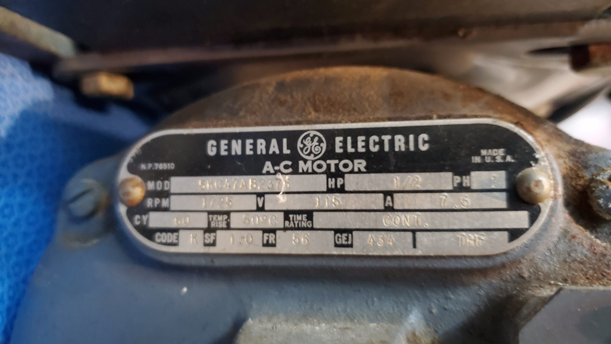

I also picked up a spare 10er for $40 and it came with a speed changer. I'm hoping its in better condition than my current one, so I could replace the pulley shaft or the entire speed changer.
Jointer guard with new spring & washer

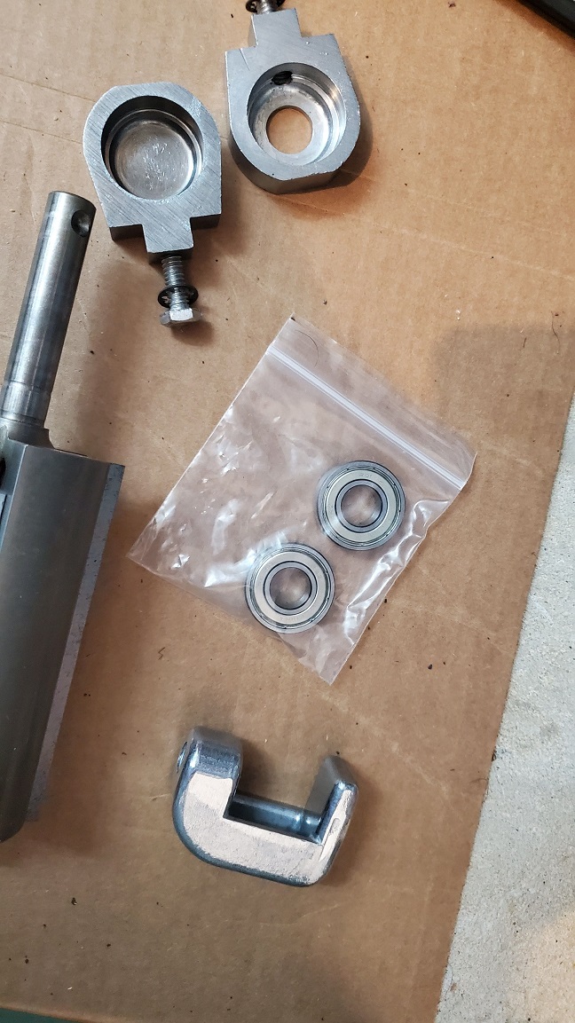

New jointer bearings & shaper clamp
Cleaned sharpener - Just noticed I'm missing the "file head" that holds the file.

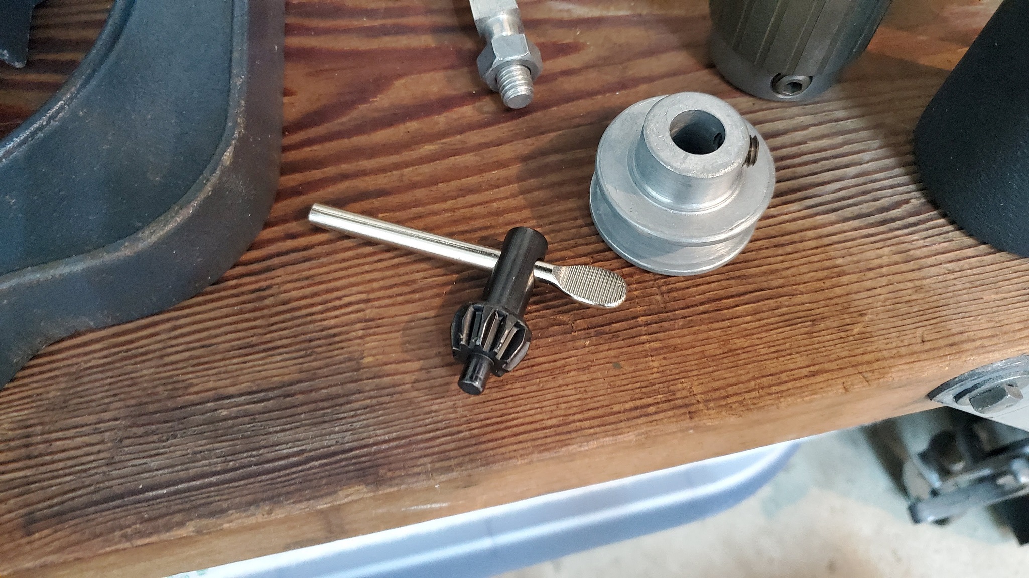

New chuck key
Spare 10er
