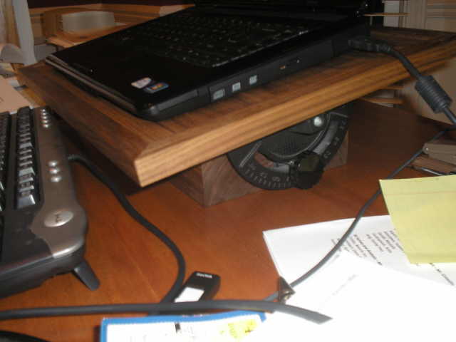

Here is a spare-time project from the last couple of weeks. My wife decided to get a new, higher office chair. She then wanted to move the keyboard and everything above the desk-surface rather than on/below it.
I had one junk miter-gage that I decided to employ (eBay said it was Shopsmith, but on arrival it looked like a knockoff). I re-used it as a Table Trunnion:
[ATTACH]10914[/ATTACH]
The lower wood piece is 2" thick walnut for mass and stability. I cross-cut that on the Power Pro, very cleanly.

Chris,
That's a nice laptop stand. One question -- the trunnion that's a repurposed miter gauge -- is there anything on the other side, or is the table pivoting/supported on one point?

juwester: Hi and thanks!
There is about 3-4" length of the original miter-bar sitting flush in a mortise in the base wood-chunk. The miter's 'pivot' is just above the wood base piece. The miter 'lock knob' would originally be on a threaded stud, but I changed it to a piece of all-thread that goes into both the miter-bar and the wood to help hold it better.
The opposite side of the table sits on a simpler "trunnion." That is just a piece of 3/8" steel dowel that goes into holes on the table-assembly and the base-assembly. It is much like a Shopsmith 500 table, overall.

Chris,
Thanks for the explanation. might have to make something similar myself!
