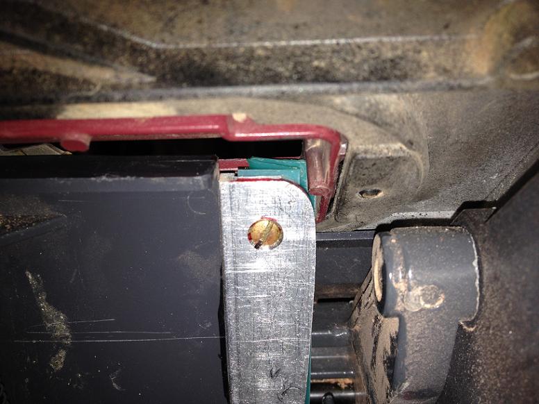

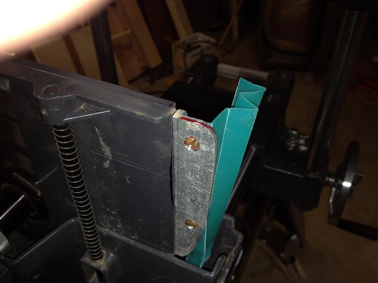

My accordion style dust deflector performed extremely well with normal and dado cuts. To get good dust collection with the table flat, the deflector must go up above the part of the lower saw guard the table rests on and in fact right up inside the table insert. When tilting the table this becomes problematic for my design because the right side of the insert is lower than the left;this is why the front lip on the lower saw guard is beveled. A small change in the deflector solves this problem. The deflector is held to the angle aluminum with screws and nuts (and now washers). All that was required was to elongate the original attachment holes in the deflector into slots. This allows the deflector to be set to its optimum height for normal cuts, and to be pushed lower to accommodate bevel cuts.
Here is a photo with the deflector at maximum height (for normal cuts):
[ATTACH]23265[/ATTACH]
And here is a photo with the deflector at minimum height (for 45 degree bevel cuts):
[ATTACH]23266[/ATTACH]

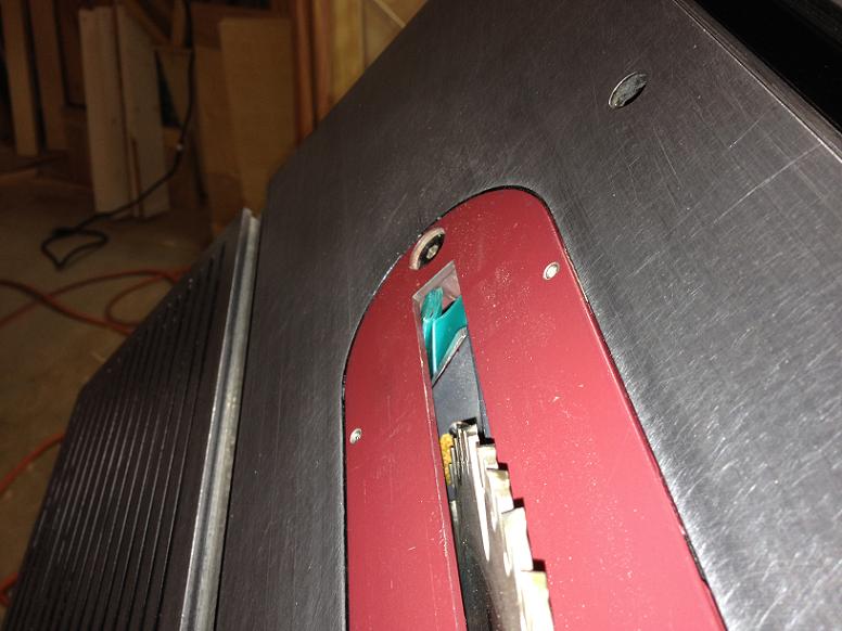

Here is a photo from the back of the table looking forward showing the table tilted and ready to make sawdust. The deflector is visible at the front of the insert:
[ATTACH]23267[/ATTACH]

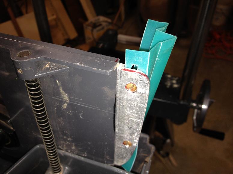

To accommodate tilting the table, the the lower saw guard is at its minimum width to allow the tie bar guard to slide past the right side of the lower saw guard. This requires the accordion dust deflector to be collapsed to its minimum width, as seen in the prior photo. Here's what it looks like below the table:
[ATTACH]23268[/ATTACH]

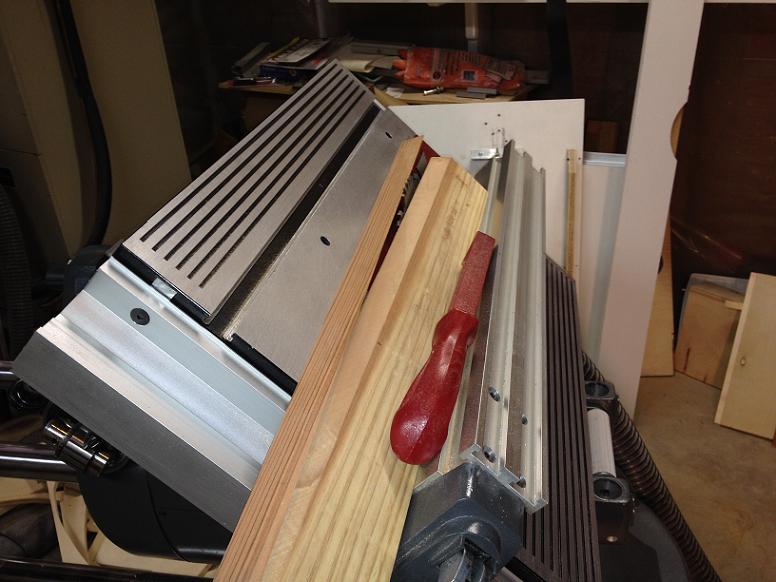

Here's the bevel cut I made with the accordion style dust deflector:
[ATTACH]23269[/ATTACH]
That cut goes all the way though and along the full length. I put the pieces back on the table (as it turns out I flipped them) for the photo and probably didn't arrange them that well.
But what matters is this photo that shows the result:
[ATTACH]23270[/ATTACH]
Imperfect -- but better than what I get without the deflector.
There's a short video of making the cut on YouTube;
unfortunately it is hard to film below the table, particularly when making bevel cuts so it isn't the greatest. If you wish to see it, here's the link: http://www.youtube.com/watch?v=2dLb-YaWs3M
Overall, I think I am done tinkering with the dust deflector for a while. It works both with the table tilted and flat and with dados; but does require some care and attention to set up before the cut. About the same amount of care/set up it takes to get the lower saw guard set to the correct width. I would love to find some rubber or silicone material in an accordion design to test as a material but have been unable to find anything on the web.

It looks to me like you have made great progress and I understand why you are hesitating to make more changes. Go make sawdust. Time will tell.algale wrote:Here's the bevel cut I made with the accordion style dust deflector:
There's a short video of making the cut on YouTube]http://www.youtube.com/watch?v=2dLb-YaWs3M[/URL]
