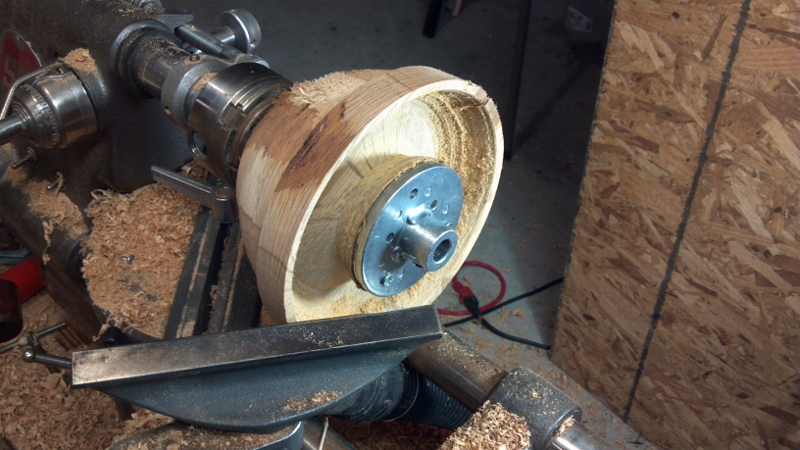

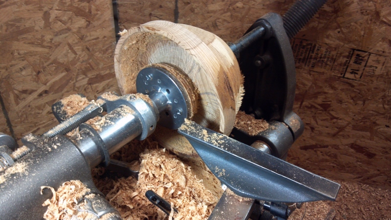

Tried different approach to turning bowl
Post by fredsheldon »
I tried a different approach to start turning the interior of the bowl and have found there is less vibration due to the fact the face plate had a good grip on the work and prevents vibrations.
[ATTACH]22515[/ATTACH]
I started turning the interior of the bowl before swapping ends like I normally do. Having the faceplate right next to where I'm cutting provides more stability and less vibration. I really like my Carbide square cutter, I can turn three complete bowls with just one cutter, which only cost $5.00 on E-bay. And no more sharpening to slow me down. Check out the large shavings, as good as my gouge does. I even have a diamond honing card that I can use to sharpen the carbide cutters if I wanted to.
[ATTACH]22517[/ATTACH]
Now I can remove the faceplate and secure the work with the live center after swapping ends like before, the only difference is I have already removed a good portion of the interior.
