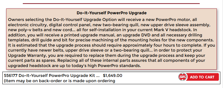

If I put an old quill in a Power Pro head stock and can't/shouldn't run it at "full bore" what is the point of a Power Pro? Yes there other advantages but com'on man. 7200 RPM I thought the standard SS was 5200 RPM (5700?), half the Power Pro. Why do you think the DIY kit comes with a new quill? As had been said the part numbers have changed, sooo...
Because the part number description says it does:
Capture PP DIY Kit Contents.PNG (71.33 KiB) Viewed 5192 times
