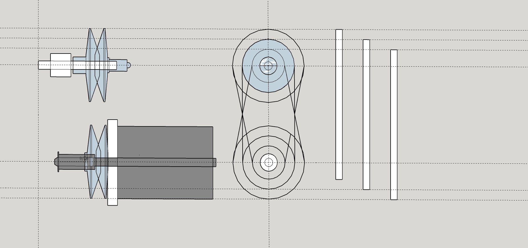

No matter the width of the belt, if you run the speed control up until the belt is near the perimeter of the sheave but not above it and then set the high speed stop, the belt should never ride higher than that.
Having set the high speed stop, if you adjust to low speed the belt should ride in about the same position on the idler sheave. I say that with the understanding that if using a non-standard belt - all bets are off.
This illustrates what I believe the belts do as one moves from one extreme to the other.
