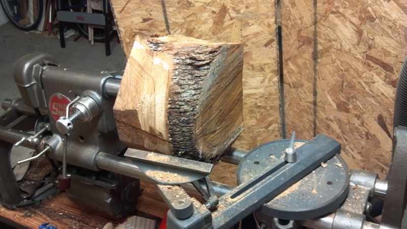

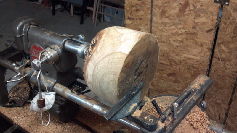

Can you turn a 15 inch out of balance wet wood blank on a 10ER.
[ATTACH]22553[/ATTACH]
Too big to round off on my bandsaw so I had to do my best with the chainsaw . This has created a really out of balance piece of wet wood. Is the 10ER up to the task.
[ATTACH]22554[/ATTACH]

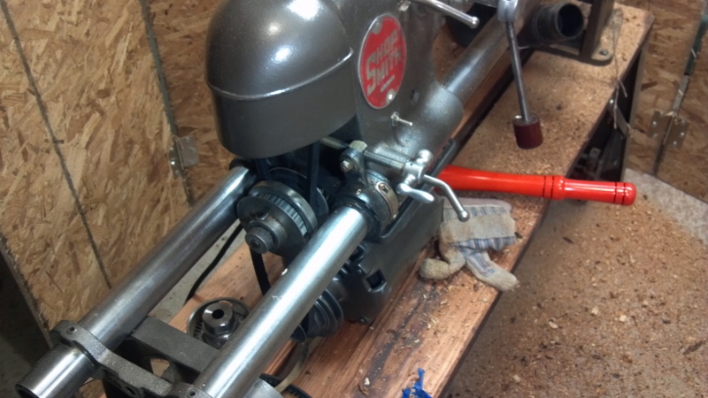

Well for sure I needed to slow things down from the stock 800 rpms so I won this speed changer on E-bay for $105 this week in the hopes it will slow things down enough to trim a large block round. Did it work?
[ATTACH]22555[/ATTACH]
Well to my surprise, yes it did. I just cranked the speed changer down to the slowest speed possible and the block shook a little but the lathe didn't dance all over the floor. So how does the 10ER match up to the V520 now that I have the speed changer. I would say that the 10ER will be my go to lathe for all of my turning projects from this day forward.

skou wrote:Fred, seems like you're a sold customer.
BUT, I would have used the tailstock during the rounding-out process. At least, until it was in balance.
Don't forget, you've only got 1, 5/8ths inch spindle. And, Shopsmith "ain't" makin' any more.
If you can find an extra quill on ebay, (or wherever) get it.
Oh, that speedchanger's handy, isn't it? Worth every penny, too.

Steve, I agree with you. I did use the tail stock with two extensions on the live center to turn the block round. I also ended up having to use the stock carriage and tool rest since I couldn't span the UTR with the live center installed to turn the interior of the bowl. The photo above shows the block right after I had swapped ends and removed the face plate. And I have 3 10ER's. One is a spare one is my drill press and one is now my lathe.
