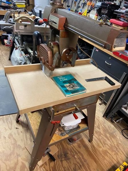

Got my SawSmith cleaned up and running. Late in posting a pic. Had to replace the capacitor, repainted the stand, replaced hardware for the stand, put down a new temporary MDF table on top of the original table. Lubricated the sheave and cleaned up the rails. Before and after pics attached. Thanks to those who helped me get parts and lent some good advice.

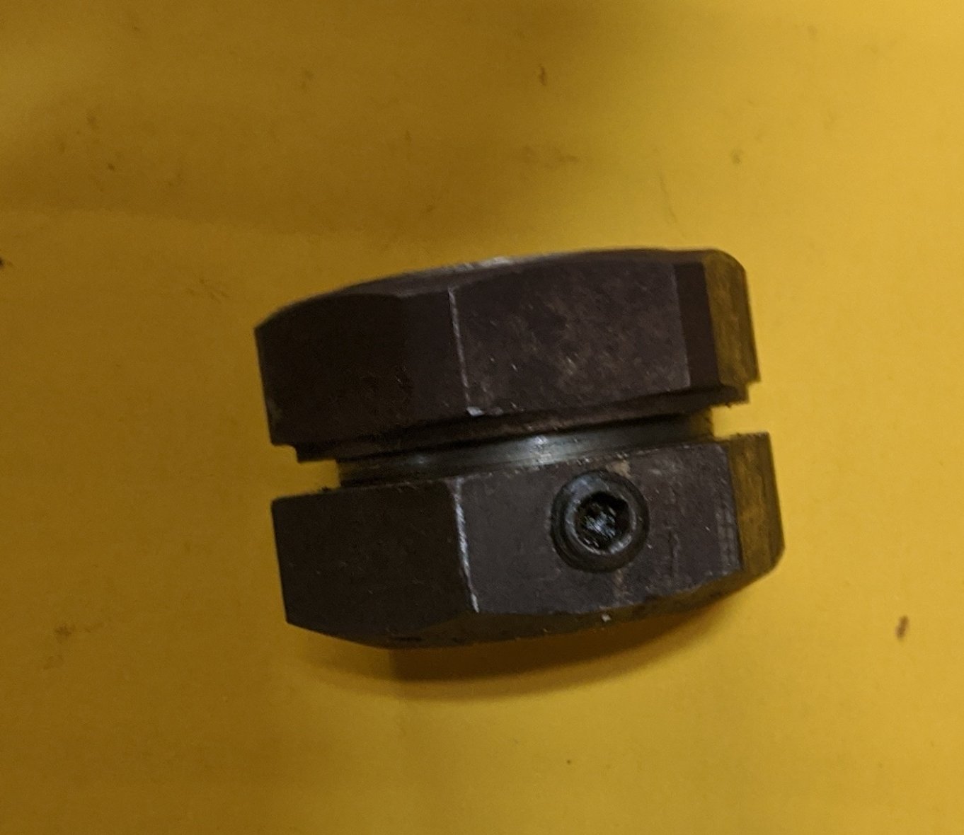

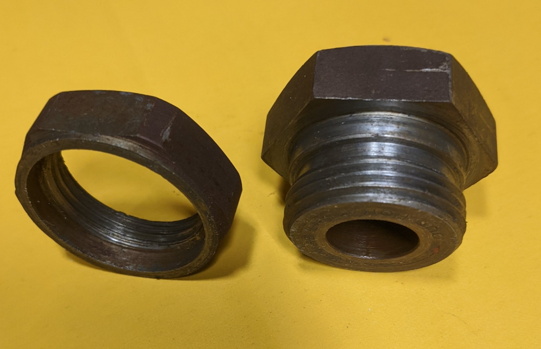

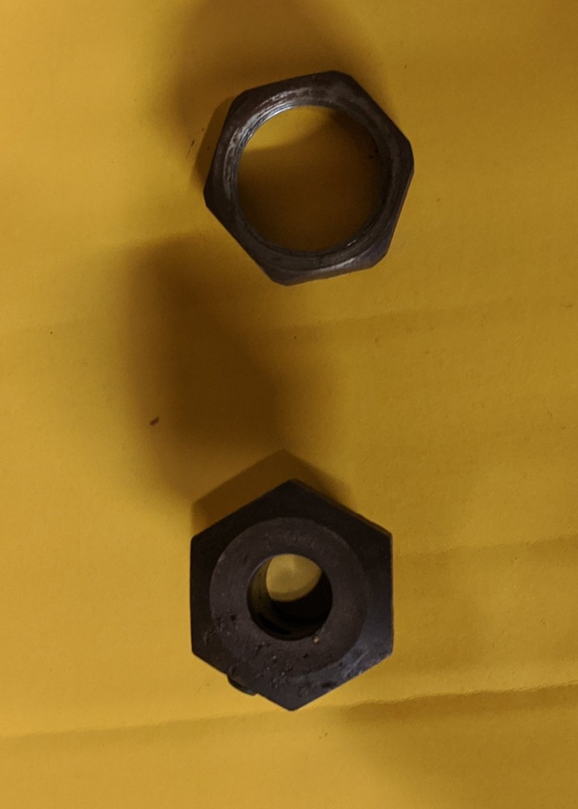

I'll put up some pictures of the spindle and arbor to show what I meant. First looking at the arbor on the blade it seemed kind of small compared to typical Shopsmith arbors, but off the blade not so bad I guess. I can see its heavy enough for a regular spindle.mlwass wrote: Mon Jul 05, 2021 8:01 pm I have used the arbor with set screw several times mainly for drill press use and it has worked fine.
The part that worried me was the threaded spindle and the set screw locking it on. I suppose it works but it seemed like there wouldn't be all that much contact between the arbor and spindle just on the threads, and of course no contact on the flat. The metal seems to be strong and hard so perhaps my concern is misplaced, but it is something I haven't seen before.
