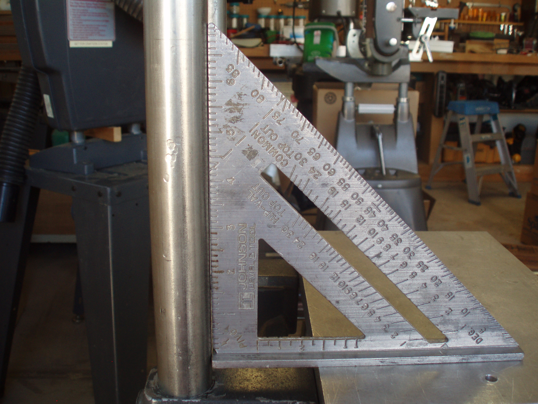

So is it this parameter that we are talking about or at 90° to this. If the two extension table legs are not parallel to one another, I don't see how they could be moved up and down but that goes for what is shown here also.
- Sq to the Tubes 003.JPG (1.14 MiB) Viewed 1971 times
Re: Truing, As Best You Can, Shopsmith Table Tops
90 degrees from that. The spt support tubes are not vertical when the way tubes are horizontal. If the two ends were off the same amount and direction it would not matter. There is no problem with the two table tubes not being parallel.
When the aux table is adjusted to be horizontal at the right end, it is not at the left end. That is what Jsburger encountered.
Very small fractional angle causing less than 1/16" left/right slope of the aux table.

That is exactly the problem here. The aux table support tube holes in the right end casting are not normal (perpendicular) to the way tubes. The left end is fine. Also remember this is the double tilt end castings.JPG wrote:90 degrees from that. The spt support tubes are not vertical when the way tubes are horizontal. If the two ends were off the same amount and direction it would not matter. There is no problem with the two table tubes not being parallel.
If they were both off the same amount in the same direction there would be no problem.
So I have two extension tables marked left and right, problem solved. BTW, I bought the second aux table when the machine was single tilt for the same reason. As you confirmed your goldie has the same problem so my guess is that many many machines have this problem. If someone has a machine that does not have the problem consider yourself lucky.
