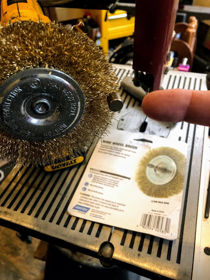

Hats off to @rdhelm who asked the simple question “When you used a brass wire wheel, was it really brass coated steel?” He went on to say that brass-plated steel wheels were all that he was able to find. Well, nowhere on the package does it say, but a quick magnet check proves that yes, it is most definitely a ferrous metal! I feel ripped off, but it did do the job just fine without damage to my bandsaw wheel.

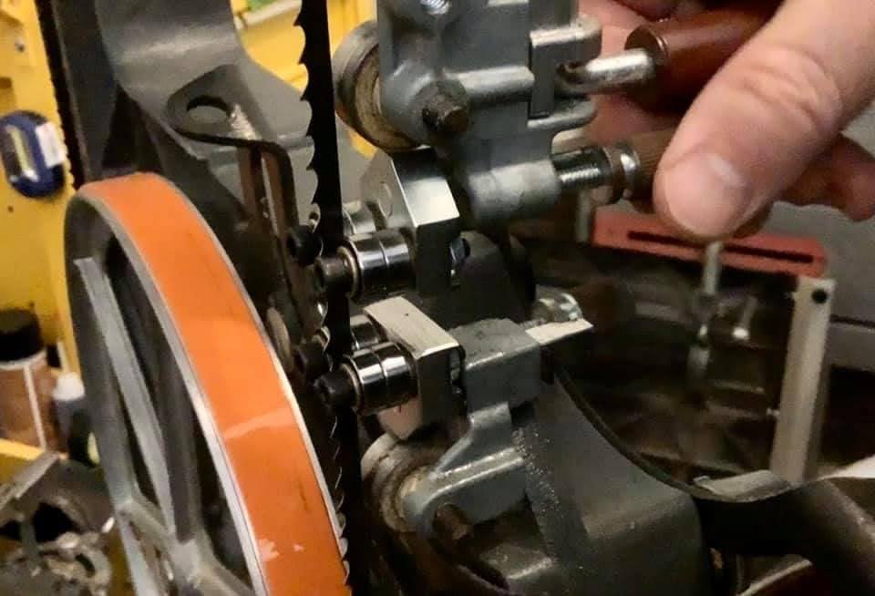

Here's a screenshot of the Carter ball bearing blade guides installed on the Shopsmith bandsaw. Looking forward to doing some cutting this week once I get the table shimmed.

Ed in Tampa

Good show! Enjoyed the Carter upgrades! Also I found it interesting that many wire wheels sold as brass aren't. Thanks Scott!
