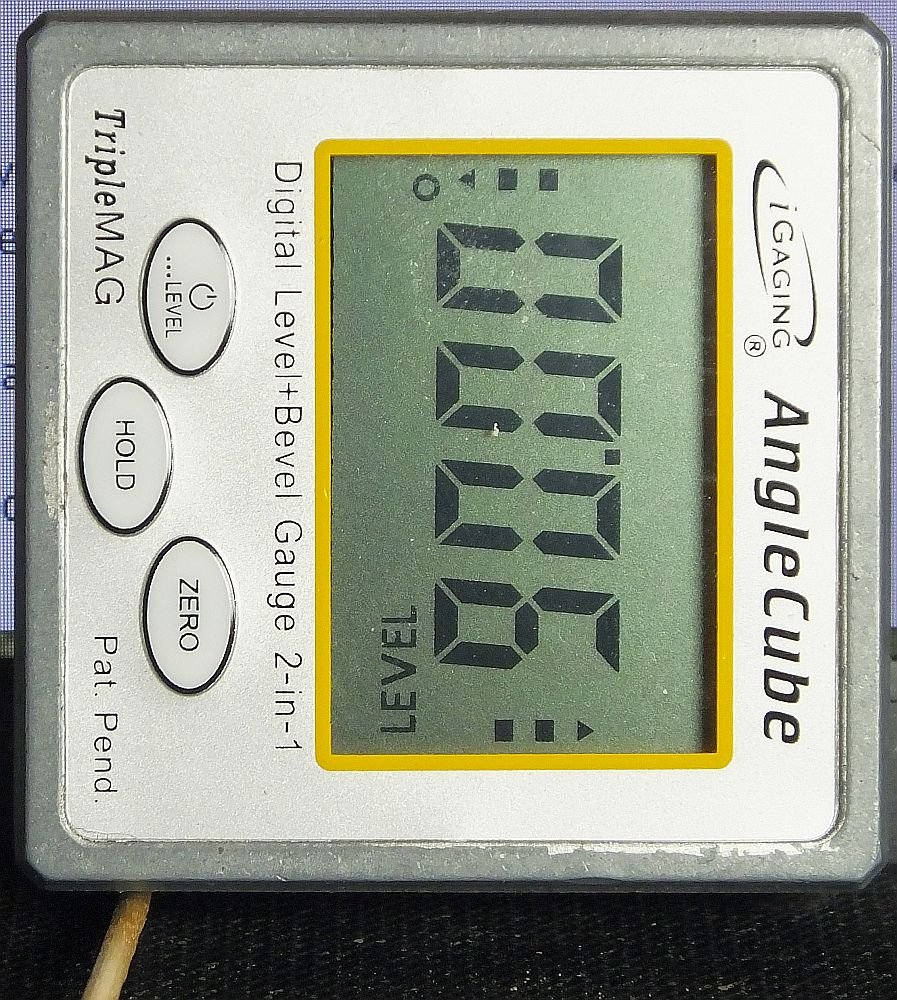

What an anglecube displays as it approaches 90°, through 90° and beyond 90°.
First approaching 90° by rotating clockwise(same as Goldie pix above).
CW LT 90.jpg (260.15 KiB) Viewed 1324 times

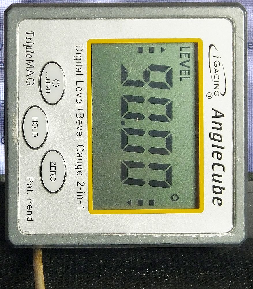

Then reaching 90° by slipping a tooth pick under the left bottom corner.
CW 90a.jpg (247.7 KiB) Viewed 1324 times
Note the display is still 'normal' orientation.

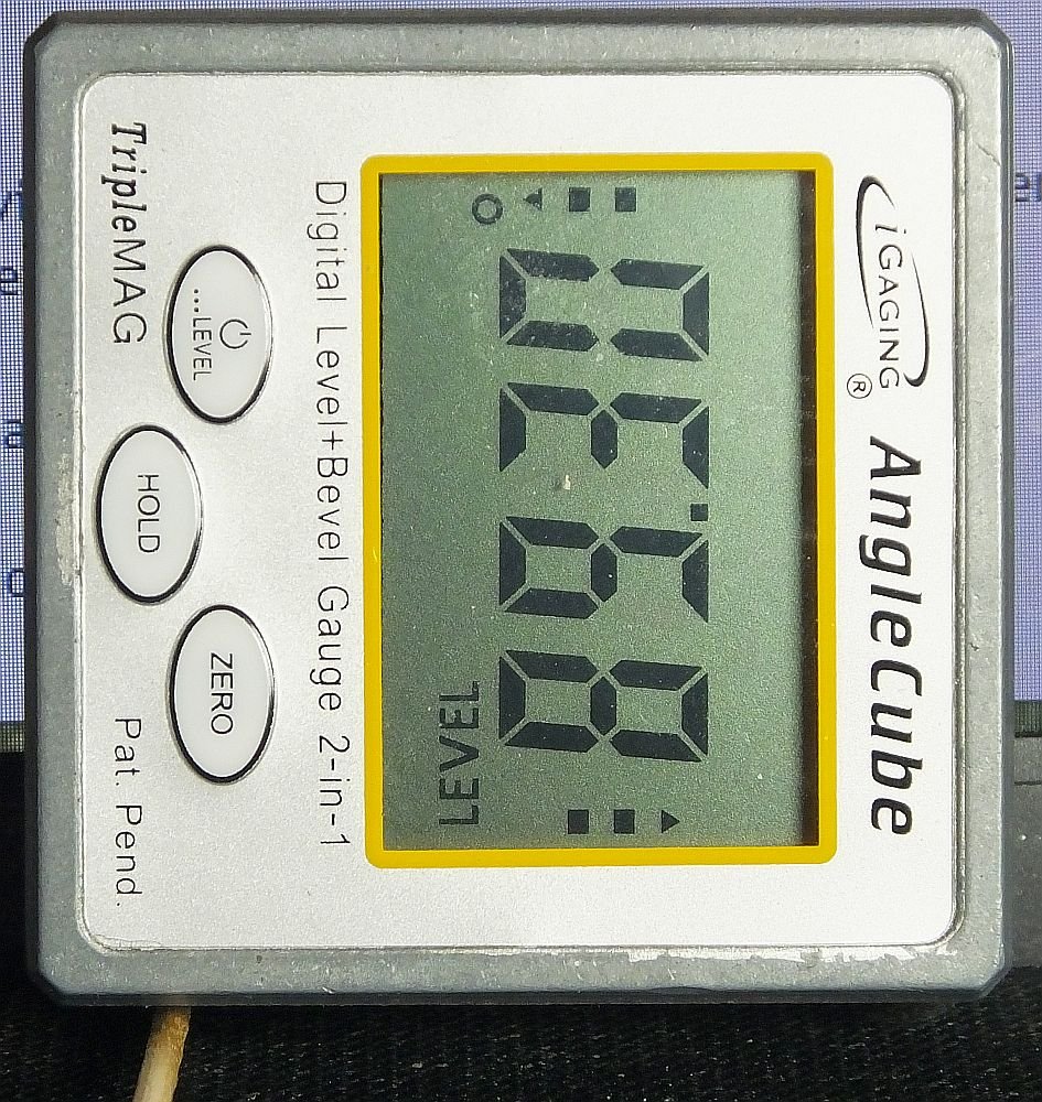

Then rotating a very small amount.
CW 90b.jpg (251.01 KiB) Viewed 1324 times
Note it still indicates 90° but the display is inverted and the arrows have reversed their indication, but their meaning is the same(up arrow high side/down arrow low side). The arrows are interpreted from the viewer's viewpoint reading the display with the values 'right side up'.(i.e ignore the fact that the display is inverted on the cube - read it 'normally'.)

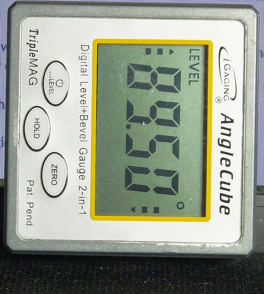

Further rotation decreases the angle amount displayed.
CW GT 90.jpg (272.17 KiB) Viewed 1324 times
The display is again inverted(upside down). This indicates an angle less than 90° that is the same as under 90° CCW rotation even though it was approached by rotating the cube CW. i.e. history is irrelevant - only angular direction from horizontal is indicated.
