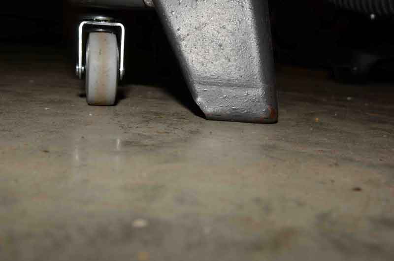

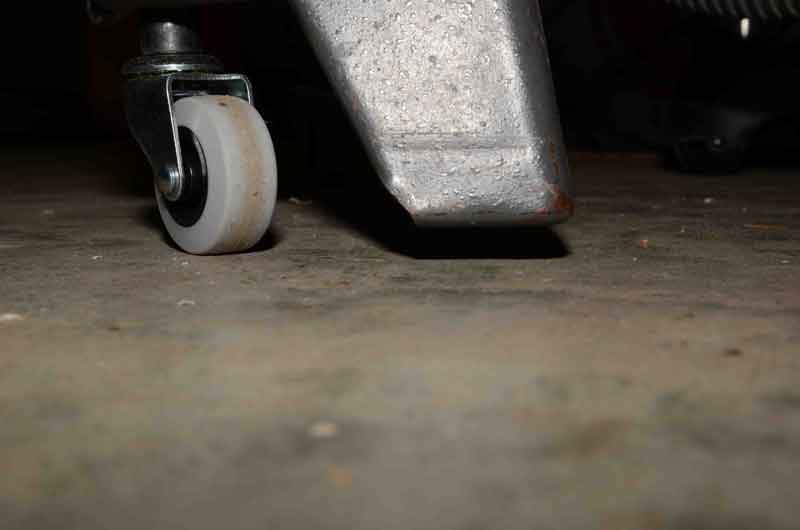

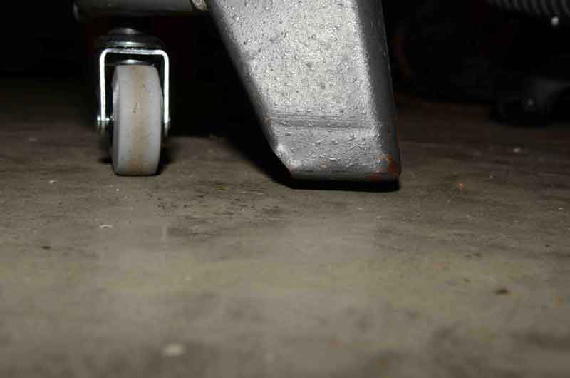

I installed the Menards casters today
Post by cooch366 »
and here are 3 pictures (all 3 settings) when installed (it's nice to provide help for a change, rather than taking:) )
No problems in moving it, it rolls so much eaiser than the old plastic casters, and the best part is no modifications needed (ie drilling)
Thanks again for the help.... Steve

I don't know how to add pictures directly to the post, which is why they are attachments...
