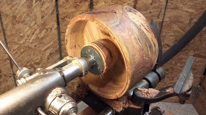

Turning the inside of the bowl before swapping ends is proving to be the way to go. I do have to hold the tool with my left hand but that seems to be no problem. I get no vibration by turning as much of the interior as I can using this method before switching it around.
[ATTACH]22635[/ATTACH]
This is the 12th bowl from my new batch of logs. I have found these larger bowls are taking longer to complete. I'm only turning one a day now and I skip a day or two between bowls. I'm pacing myself so I won't get burned out.

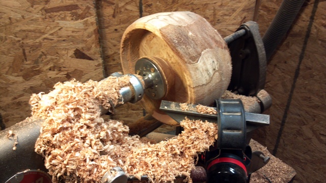

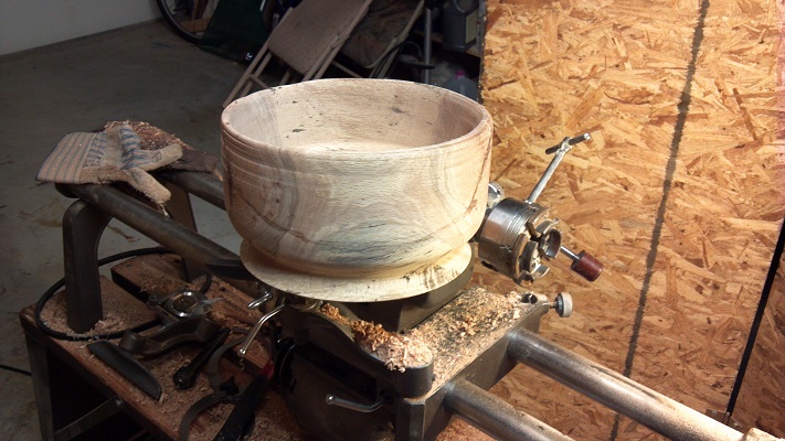

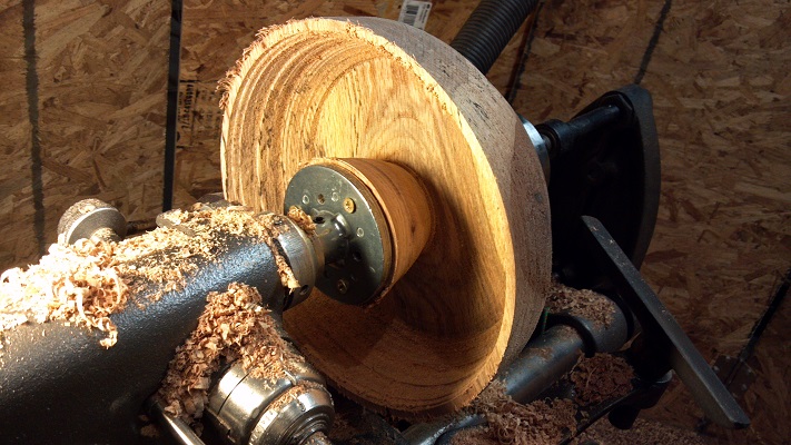

Here is another bowl where I'm turning the interior before swapping ends.
[ATTACH]22650[/ATTACH]
This one I went 2/3's the way into the interior before turning it around to finish.
[ATTACH]22663[/ATTACH]
This one I turned the interior all the way to the bottom before swapping ends to remove the center stalk.
[ATTACH]22651[/ATTACH]
Can you see where I had another breakout and repaired with ca glue :mad: I was trying to make just one more pass to thin out the wall of the bowl before bagging it up to dry out. I was able to complete the turning and sanding after leaving it to dry overnight and it seems to be holding up well. I was so upset after spending 5 hours turning this large bowl that I forgot to take a picture of the damage before gluing the piece back in.
