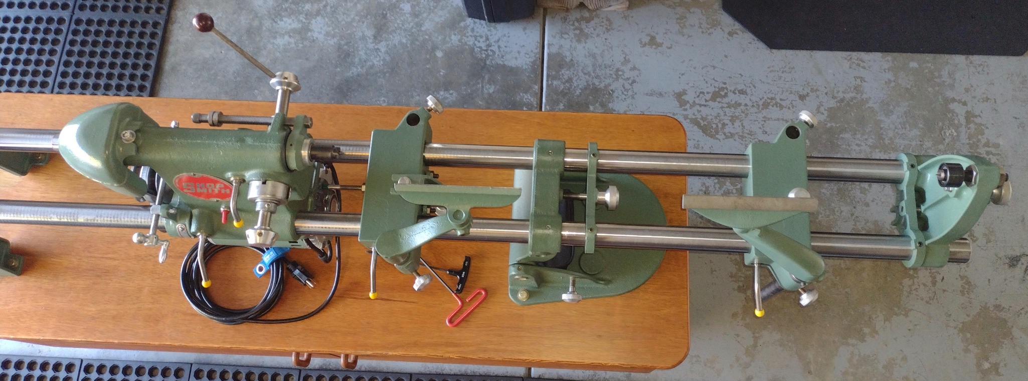

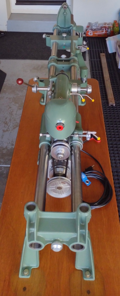

…this is currently what I am attempting to build. Both my boys are in high school and avid baseball players. They want me to turn them some custom bats, but without a lathe extension my 10e is not quite long enough. Hopefully this works out.

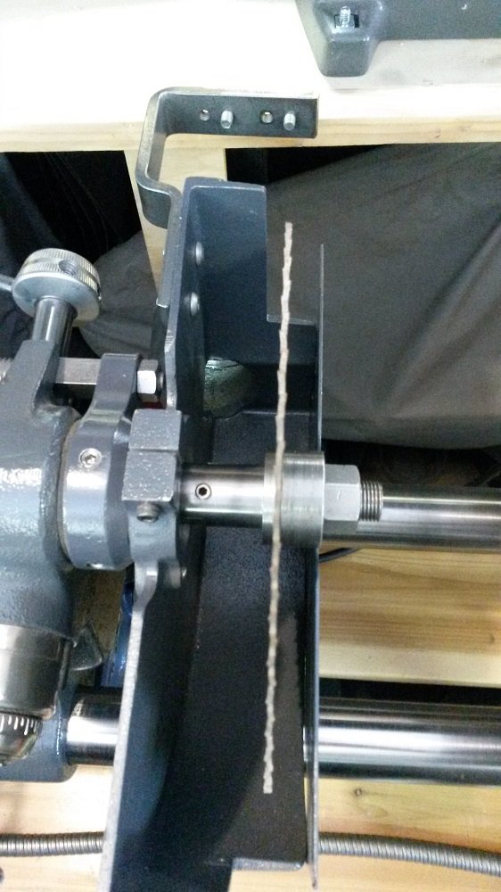

Like John I collect these rarer parts because they are rare and not really to use. In the case of the Lower Saw Blade Guard I will not use it but are for show as original but rare parts. For a lower Saw Blade Guard I actually use the one for the Mark V part number 505628 as shown below. It can be used on the Model 10's with its Upper Guard part number 505627 or the Model 10 Upper Saw Blade Guard.

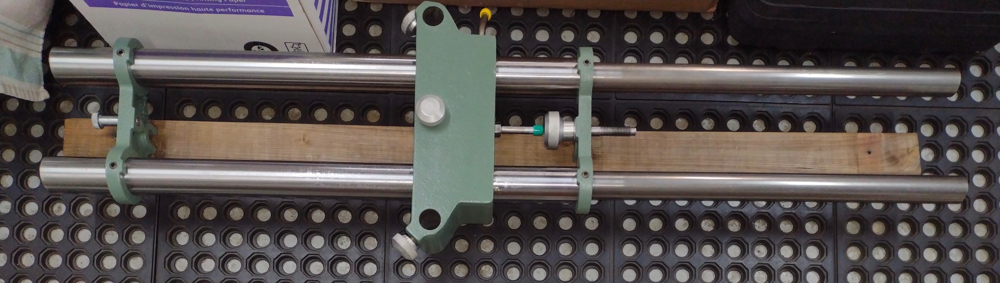

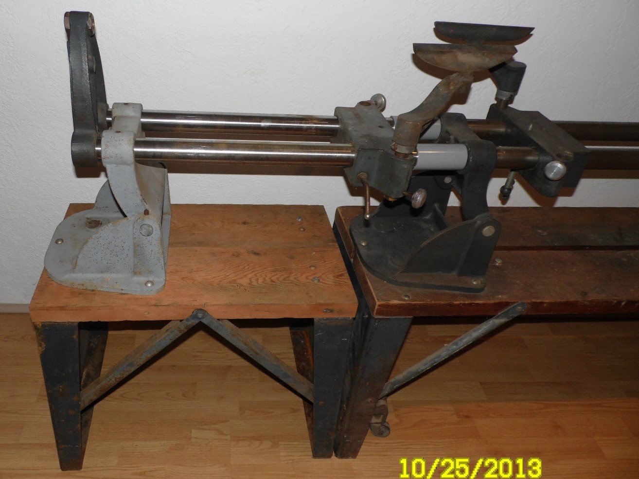

I am interested in seeing the finished Tailstock Extension mounted on your Model 10E. Yours looks like another one I have seen pictures of but have no details of how it is connected. Another type I have seen is shown below.
Sure, no problem. Still need to do some machining on the connection bars but will provide pictures when done. That extension you provided a picture of is an interesting idea. That method definitely eliminates the cantilever issue I am currently wrestling with.

54” maximum lathe capacity.

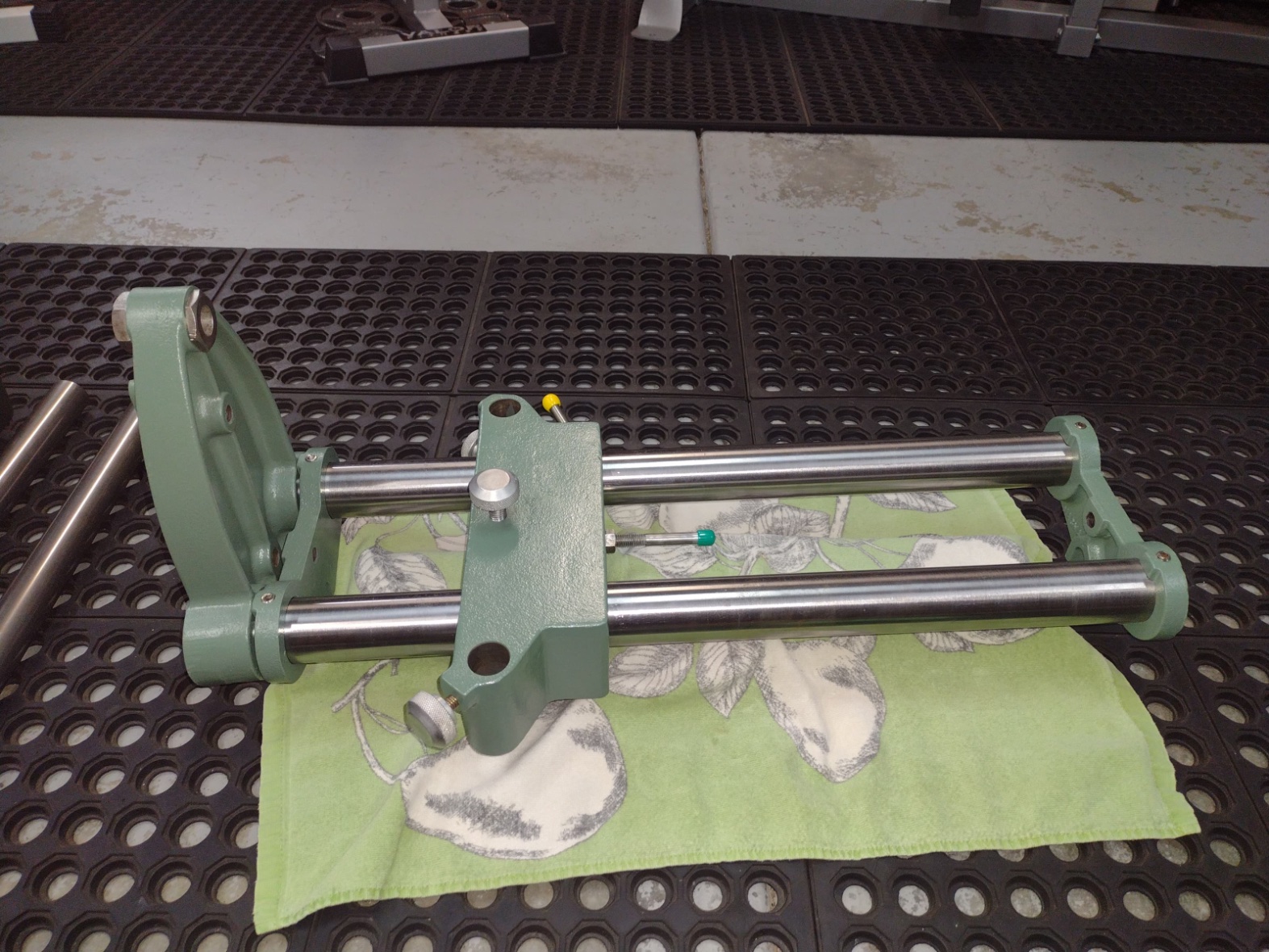

Regarding the extension, is there an internal pipe section connecting the main to the extension way tubes? Seems like it would need something of that sort to support the cantilever.

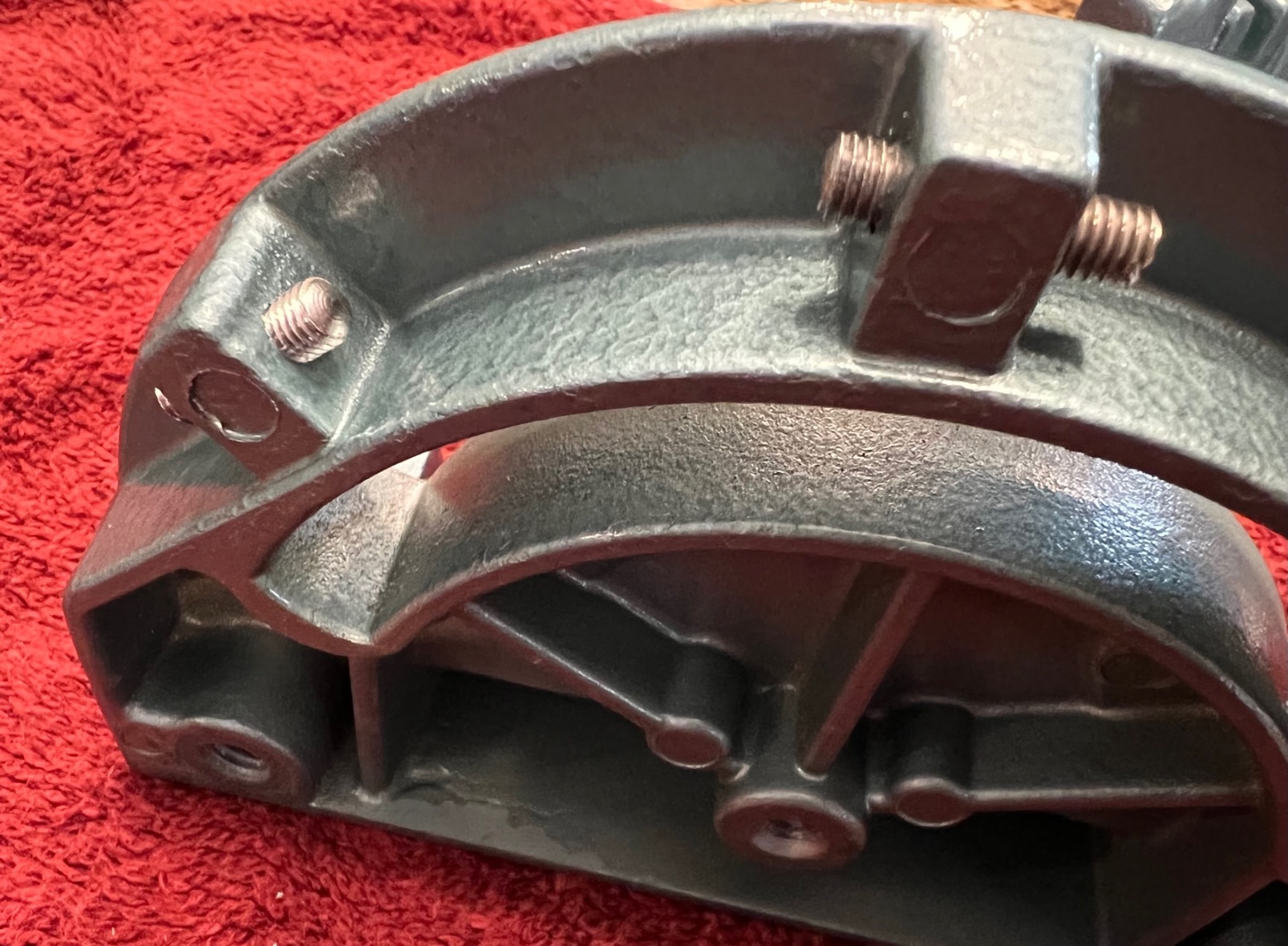

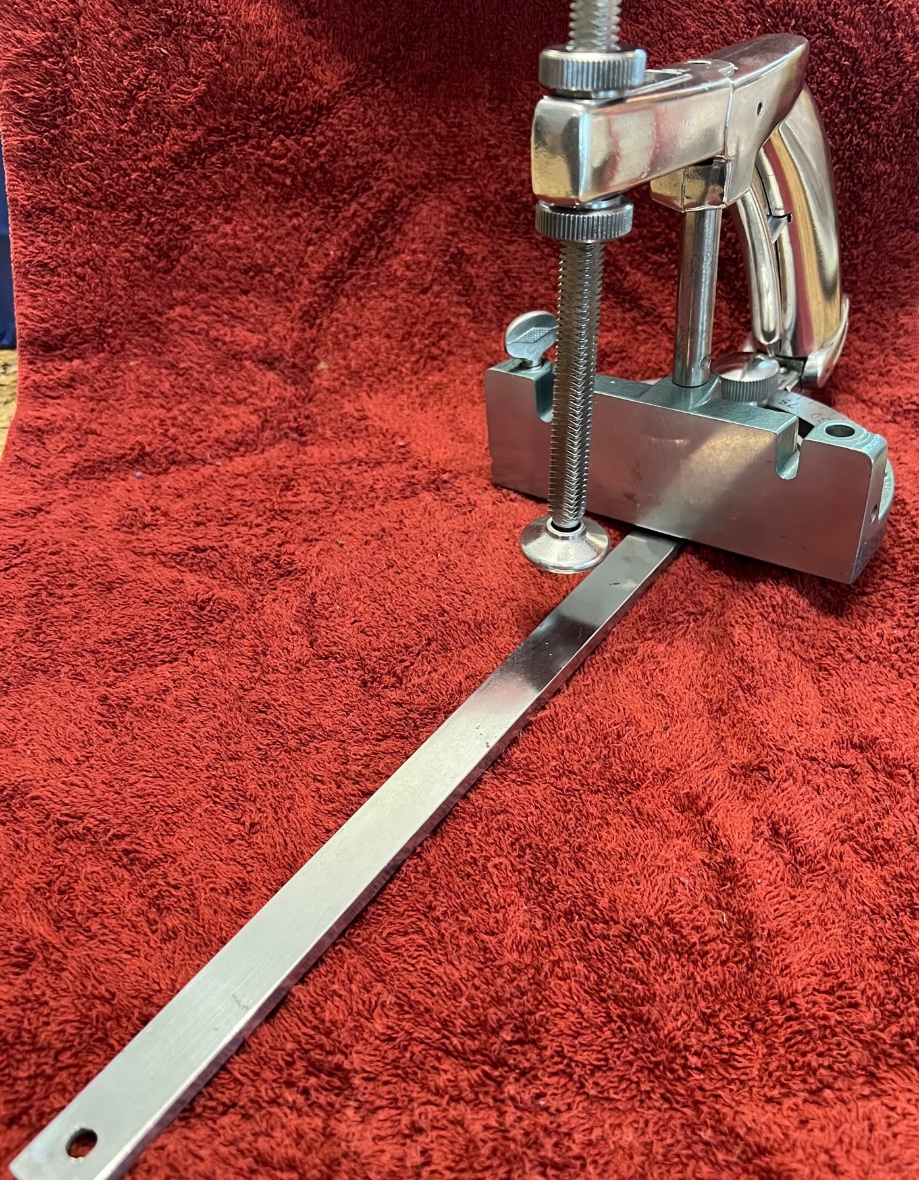

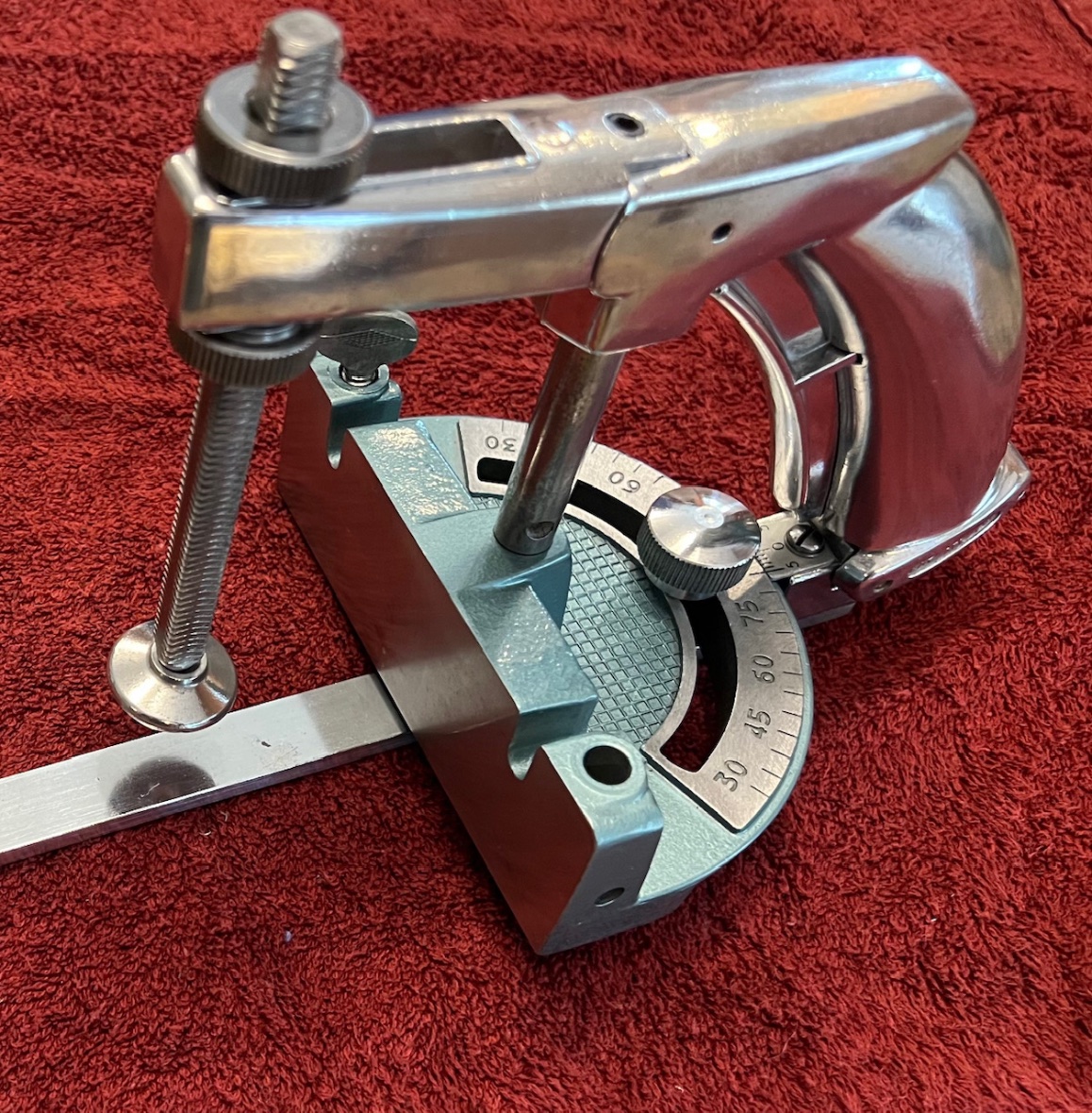

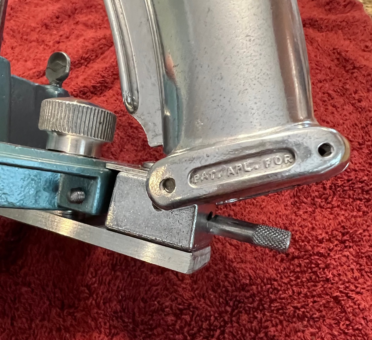

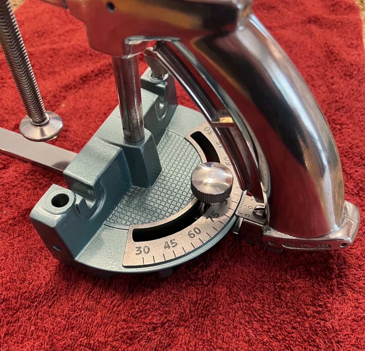

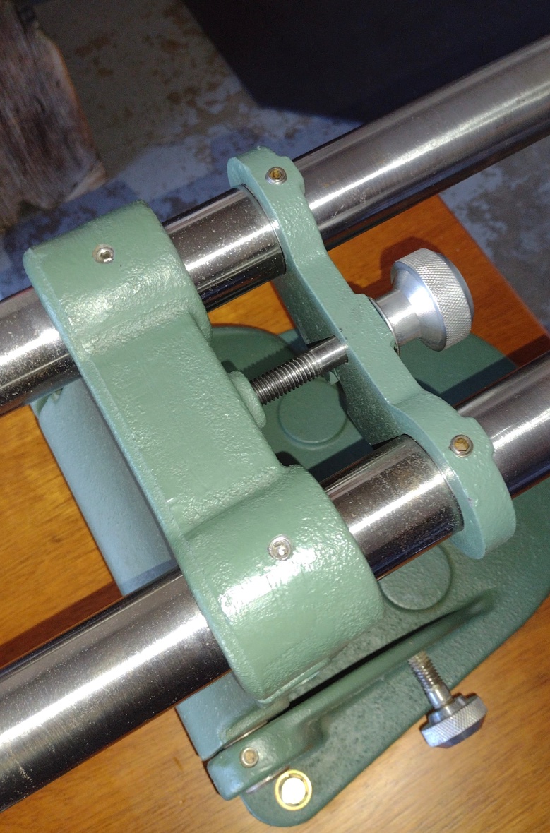

Special Miter Gauge
Here’s a recent accessory restoration for my 10-E project, and one you don’t see too often. “Wait a minute!”, you might say. “That’s clearly a greenie Mark 5 miter…
Well, this came from the period after 10-ER production ended, and Magna was looking for ways to give all those early system owners access to the new features developed for the Mark 5.
The original owner of my 10-E system (S/N E5052) loved those upgrades, and invested in things like the Power Mount Adapter Kit, and this Special Miter Gauge.
It has all the features of the Mark 5, except that nifty little expansion screw that allows you to secure a Mark 5 miter in the table slot. They even added a countersunk hole in the underside of the miter bar that accepts parts from the Universal Hold Down Kit (which of course the original owner added to this machine…).
John Dalton
John,
Thanks and yes, there are solid steel billets internally that make it extremely robust. See photo below (should have included this one originally).

jpdalton wrote: Wed Oct 05, 2022 1:41 pm Special Miter Gauge
Nice find, that one looks very nice. Been looking for one of those for years!
