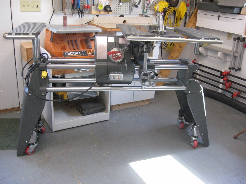

good looking wheels
I like the shopsmith wheels upgrade cause, I think they add a splash of color to an already class looking piece of equipment............[ATTACH]16033[/ATTACH]
- IMG_2086 (800x600).jpg (325.86 KiB) Viewed 2657 times
oldc6 wrote:I like the shopsmith wheels upgrade cause, I think they add a splash of color to an already class looking piece of equipment............[ATTACH]16033[/ATTACH]
Agreed now when you add a power pro and the 520 upgrade you will truly have an efficient work of art capable of making anything. Not to mention the speed range will be greatly increased at both ends and your shop will be whisper quiet. Jim
