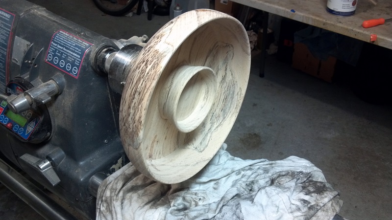

First two from second batch polished.
Before and after photos of first bowls to be polished from my second batch of over 50 bowls. To see how I applied the finish go back to post 99 in this thread.
http://www.shopsmith.net/forums/showpos ... stcount=99
[ATTACH]23103[/ATTACH]
After sanding with from 60 grit to 400 grit
[ATTACH]23104[/ATTACH]
Need to remove tenon and brand the bottom with my name.
[ATTACH]23105[/ATTACH]

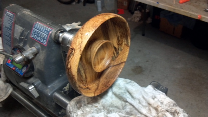

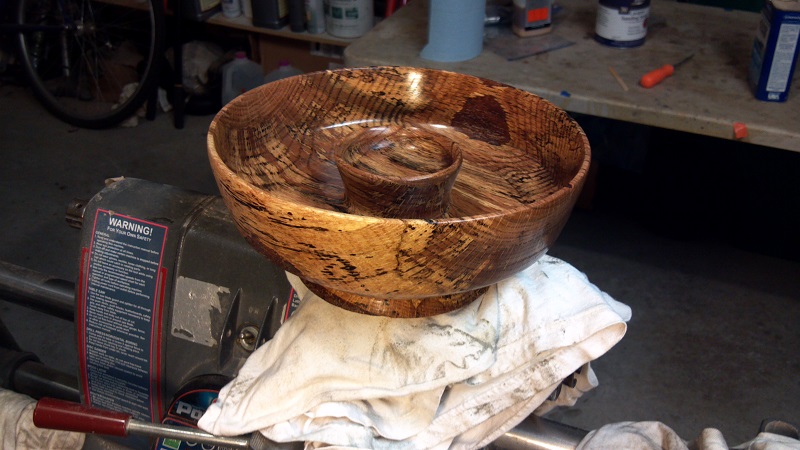

Second bowl from tonight. I like the way the center holder worked out. This will be a chip bowl with a small dip bowl placed in the center. I have 8 more just like this one still in the bags.

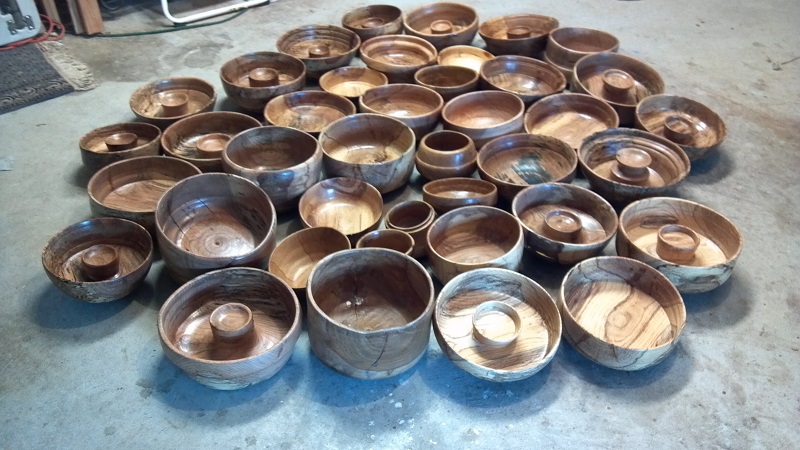

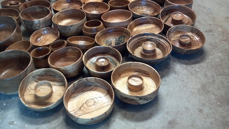

Finished with Second Batch.
Well this has been a busy day, I sanded, sealed with sanding sealer and polished all my bowls from the second batch. All I need to do now is to remove the tenon and brand my name to the bottom of each bowl and I will be ready for Christmas.
[ATTACH]23237[/ATTACH]
Fifty two bowls in this second batch added to my 38 bowls from my first batch gives me 90 bowls total for the year, more than enough to give one to everybody I know for Christmas and have a few left over.

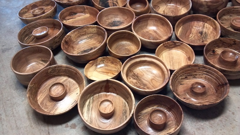

[ATTACH]23238[/ATTACH]
[ATTACH]23239[/ATTACH]
Thank goodness for Fiberglass filler and CA glue.

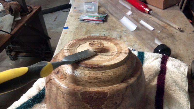

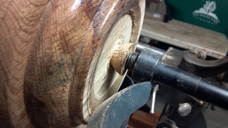

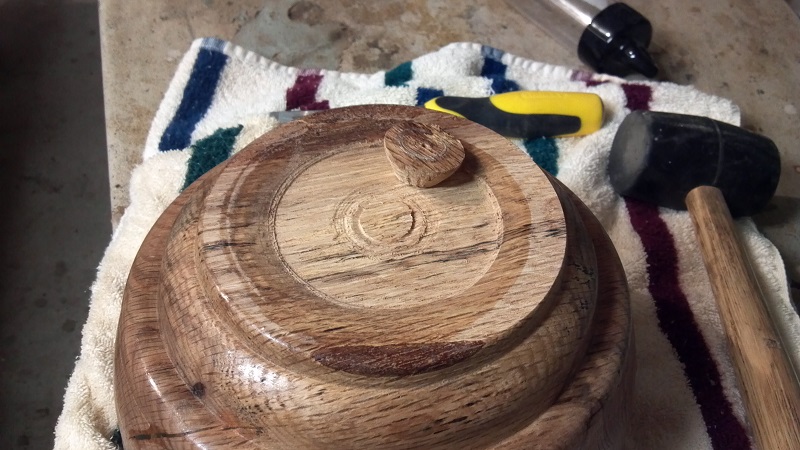

Final Cleanup and Branding
The final steps to finishing my bowls are to cut off the tenon and sand the bottom flat so I can apply my brand.
[ATTACH]23320[/ATTACH]
Cut the tenon down with scrapers.
[ATTACH]23321[/ATTACH]
Cut the remainder off with sharp chisel.
[ATTACH]23322[/ATTACH]
[ATTACH]23323[/ATTACH]

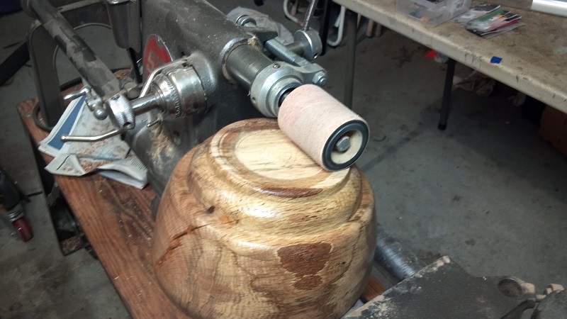

Sand nub off and flatten bottom to accept brand using the drum sander.
[ATTACH]23324[/ATTACH]

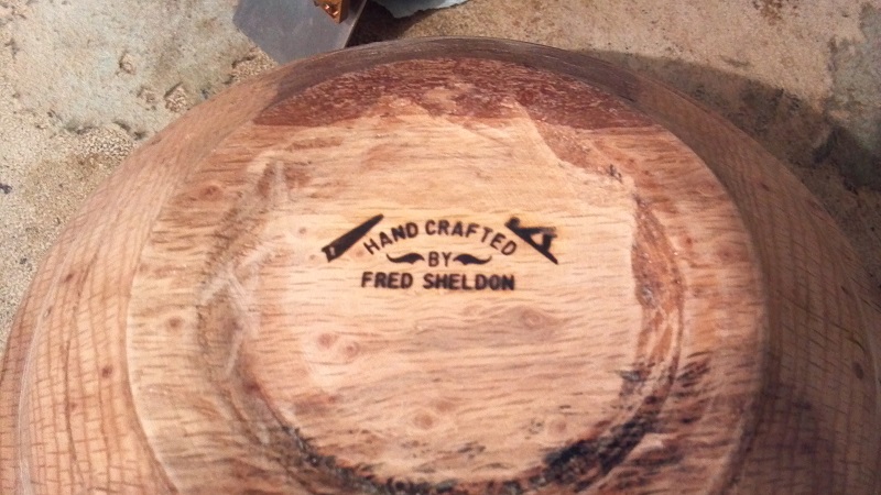

Brand applied with branding iron. Bottom must be flat to accept the brand properly. Need to apply polish to bottom and then I will be finished with my Christmas gift giving project for this year. I have branded all 90 of my bowls today. It took about 2 hours because I had to sand an extra flat spot on every bowl. It takes about 30 minutes to heat up the branding iron so once you get going do all at the same time.
