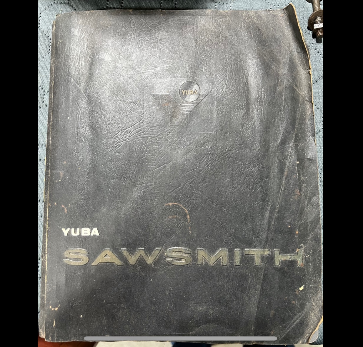

Heath - I stumbled on a pretty unique item for the Sawsmith with a system I acquired this weekend. I’ve seen these Dealer Binder folders for the Shopsmith product line, but didn’t realize Yuba maintained that tradition with the Sawsmith. I just snapped a couple of quick pics, but will scan the full contents sometime soon.
