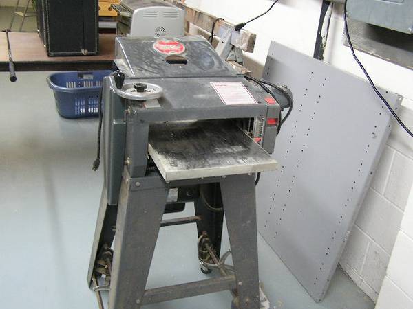

Dang, for only $75 more than your replacement parts, you could have had this.
[ATTACH]26876[/ATTACH]
Too late now! :D
I alerted my neighbor buddy the day it popped up on Craigslist, and he picked it up the very next morning. Dunno why the ad is still up.
