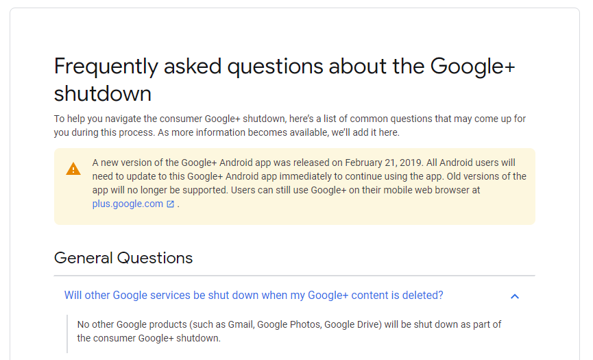

Google+ Shutdown notes:
I have received a number of email questions asking if this change at Google will have any effects on My Google Drive and the Shopsmith Materials I have posted.
Google states no, Google Drive is not affected
Everett

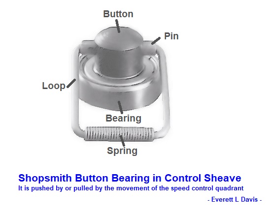

Added a file for the Button Bearing Illustration that was privately requested by a non-forum member who requested it through the Shopsmith Owners Facebook Group. It is also on My Google Drive
Everett
