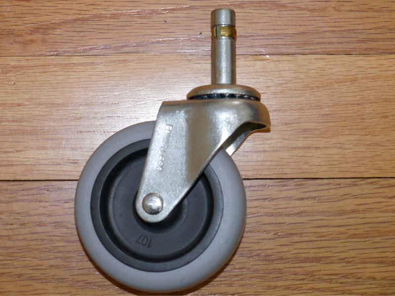

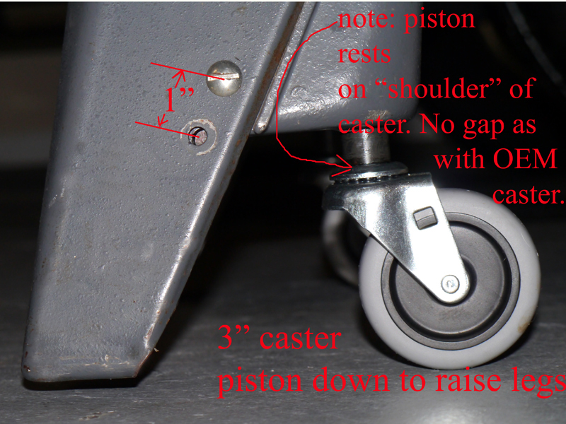

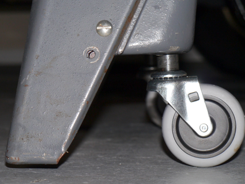

I got the 3" caster I ordered and installed them. They were from Ebay http://www.ebay.com/itm/Set-4-Faultless ... 5d321613ac and I paid $8.00 for four casters + $7.75 shipping= $15.75 total. To me, it's a no-brainer upgrade as these work SO much better!!
The stems are a little shorter than on OEM casters, so they do not bottom out inside the pistons. Rather, the weight rests on the "shoulder" of the casters. The casters are well-made and the wheels are a hard gray plastic.

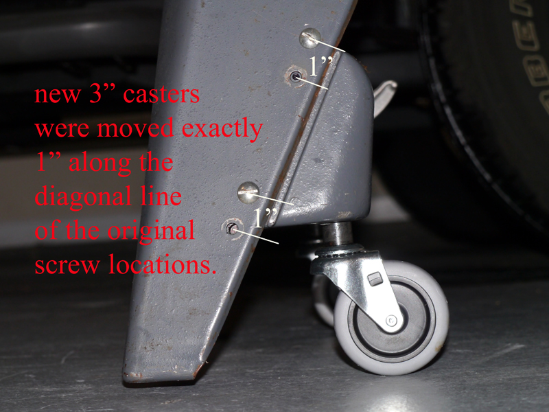

I simply drilled the holes in the legs 1" higher than the existing holes, as shown. Yes, 1" was exactly right. The only caveat was that one hole was slight off-line and didn't allow the carriage to seat correctly into the leg on one side. It was an easy fix....just widened the hole a tiny bit.
Thanks to all that posted their version of this upgrade!

JPG40504 wrote:And the other two positions?:)
Are perfect. Pretty much just like the OEMs. With the legs down, there is slight contact of the casters on the ground with plently of "play" so they don't interfere with solid floor to leg contact.
So the 3 positions are:
1-good floor contact
2-raised 1/4"
3-raised 1/2"
Fred
fgrule wrote:Are perfect. Pretty much just like the OEMs. With the legs down, there is slight contact of the casters on the ground with plently of "play" so they don't interfere with solid floor to leg contact.
2-raised 1/4"
3-raised 1/2"
Fred
You nailed it! Good job!:cool:
Are the stems more vertical than they appear in these photos?
fgrule
Posts: 138
Joined: Fri Feb 10, 2012 10:22 am
Location: Knoxville,Tennessee
Post by fgrule »
dusty wrote:Are the stems more vertical than they appear in these photos?
Hi,Dusty,
Yes,they are more vertical. I cropped the photo properly this time! Or was it that I was leaning when I took the photo?:confused: Photographer's error in either case!
Fred[ATTACH]16382[/ATTACH]
