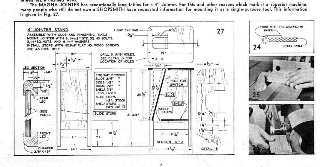

The Jointer Mounting Kit instructions doesn't mention powering it as a separate unit. http://vintagemachinery.org/pubs/detail.aspx?id=2704csxeng wrote:In the owners manual it does have plans for a bench to have it as a stand-alone machine. I believe it also says something about what motor and pulley to use.badtheba wrote:I wonder if Magna originally planned the 4E to be able to be run standalone. I haven't seen that in old marketing materials yet, but maybe someone else knows. It has bosses in the casting to be able to bolt it to a table or stand, so it would make sense to run it directly from its own motor. Of course that mounting method would make the jointer headrest unnecessary, so I'm not discounting this individual's ingenuity. As someone else mentioned, we don't know the motor RPMs, so with the right pulley setup it might already be in the best range. Isn't 6000-7000 recommended for this size jointer?csxeng wrote:
I bet at one time the jointer was an add on but the person couldn’t find the motor extension and the 5 inch pulley kit. So it was this setup that was used. Very ingenious setup as long as it works. All on one bench!
Dave V.
Sent from my Moto Z3 Play using Tapatalk
The Jointer Manual has plans for a separate stand, it says this was to meet requests after the fact.
The unit under discussion appears to have a 2" pulley on the jointer and a 3" pulley on the motor. A 3450 rpm motor, in this configuration, would turn the jointer at 5175 rpm, which is right in the ball park for the recommended speed of 5000 rpm.
FWIW, the 5" pulley and adapter are readily available from Skip Campbell at MKCTools.com.csxeng wrote:I bet at one time the jointer was an add on but the person couldn’t find the motor extension and the 5 inch pulley kit. So it was this setup that was used. Very ingenious setup as long as it works. All on one bench!rpd wrote:amboyna wrote: The longer bench is especially nice. I have to question the pulley setup on the jointer though. Typically the motor would have a 5" pulley. But since I don't know the rpm of the motor...
Dave V.
https://www.mkctools.com/sptmotordriveadapter.htm

The idea of mounting the Model 4E Jointer on a stand instead of the Model 10E or 10ER as being an afterthought is interesting. The Base/Out-feed table already had the 3 mounting holes used to mount it to the table as shown in the manual. There is no other apparent use for those holes.
The 4E Jointer using the headrest mounting and the 5" pulley setup runs at about 5000 RPM's. It uses an 1-3/4" Pulley on the jointer. Another case of the size of a part not being included in most printed materials. Kind of like the size of the speed changer belts.

That's what I felt about it. Was it that way from the first casting though, or was that too revised? I know mine has the holes, and (being new to SS) I always figured it must have been intentional from the start. I just hadn't noticed it in any documentation until the posted manual page in this thread.chapmanruss wrote:The idea of mounting the Model 4E Jointer on a stand instead of the Model 10E or 10ER as being an afterthought is interesting. The Base/Out-feed table already had the 3 mounting holes used to mount it to the table as shown in the manual. There is no other apparent use for those holes.
Is it possible that the holes were there to hold the casting in place during the initial machining process, and just repurposed to hold the jointer to the stand?chapmanruss wrote:The idea of mounting the Model 4E Jointer on a stand instead of the Model 10E or 10ER as being an afterthought is interesting. The Base/Out-feed table already had the 3 mounting holes used to mount it to the table as shown in the manual. There is no other apparent use for those holes.
