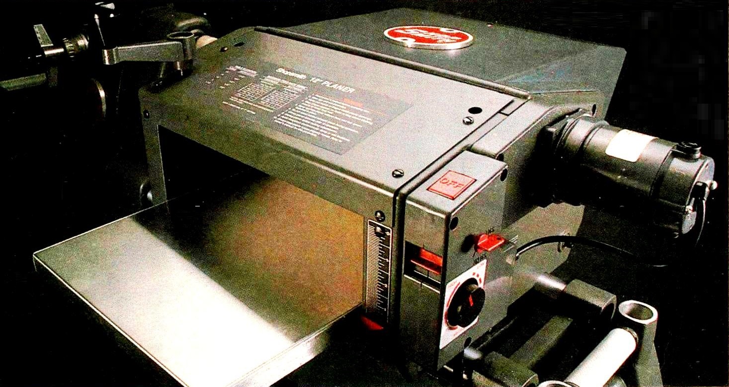

I just uploaded images of the three Shopsmith Planer Models with the OEM Stock Numbers to the Planer folder on My Google Drive, which should help anyone identify what their specific model number started out as, and how it might have been updated / modified / altered in the last 3 decades.
Everett
Everett

The 'early' planer had the round thickness crank handle.

I don’t have a early catalog that shows that round one yet. I’ve gone through all I have.
If you have one, scan and post it with the item number.
Equally I don’t have a planer service manual with an illustrated parts list showing the round crank either.
If someone has one and can scan it in color at 300 DPI please email it to ShopsmithHistorian@gmail.com
Everettt
