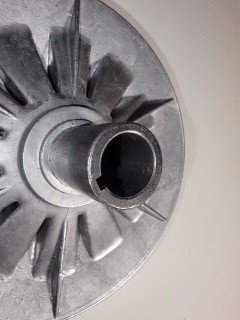

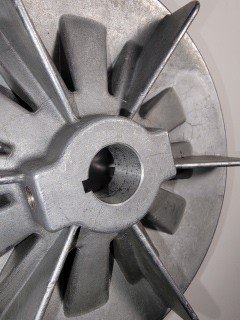

I believe all are pairs regardless of model/vintage.
Here is a MVII idler/control pair.
The 'male' hub is slightly larger than 1"(1.03)
The 'female' hub cavity is slightly larger.(1.06")
The vane tips are about 1.17" across.

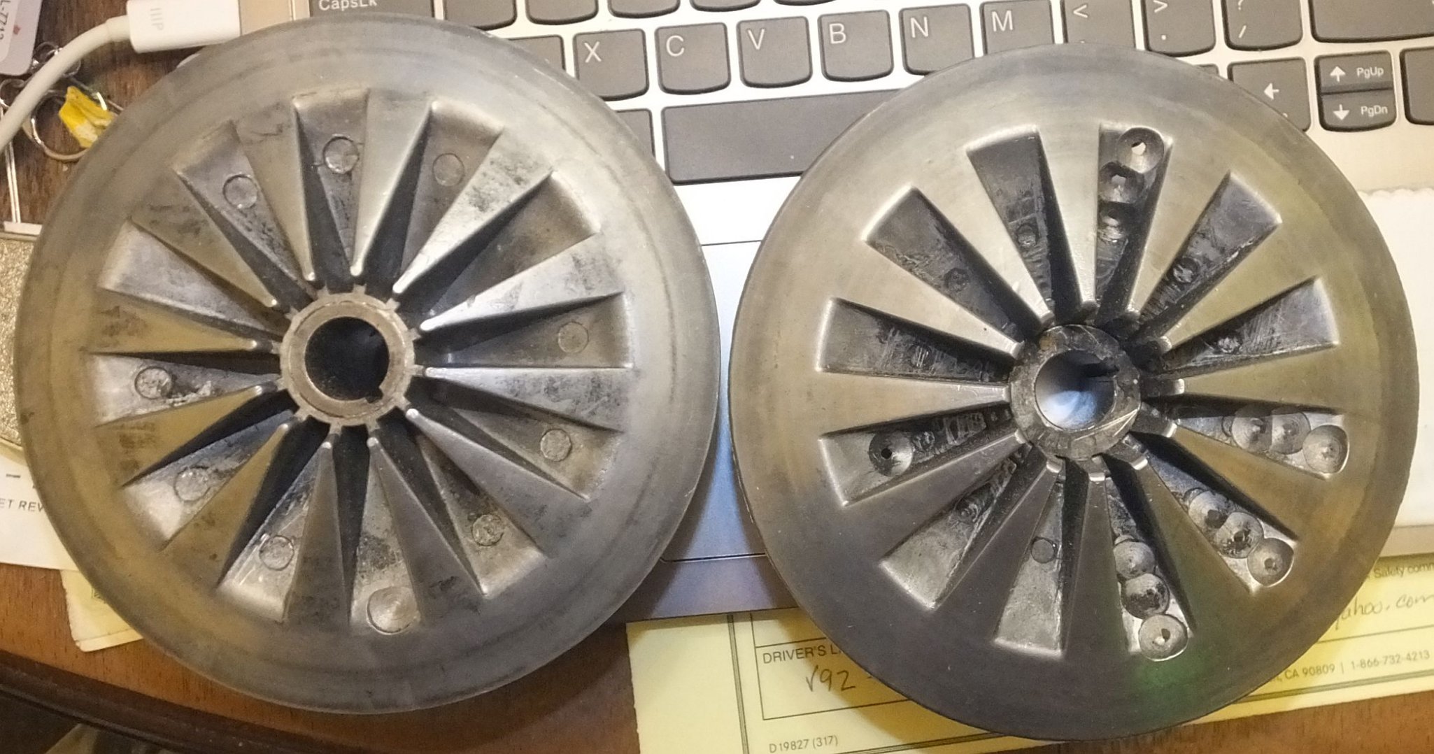

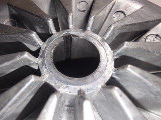

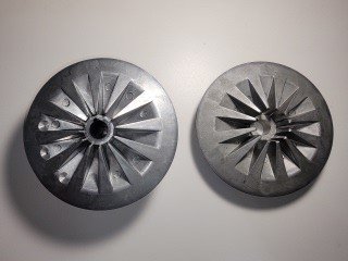

Just when I was beginning to think that I understood the Mark V speed control I learn that the fan and floating sheaves are not exactly what I had pictured. They function according to my current understanding but they do look different - especially the Fan Sheave. I guess I should have know - it is called a fan sheave for a reason.

I have been laboring under an assumption that the sheaves are all very, very similar on the vain side while the major differences were on the other side. Yes, the sheaves are all "similar" and that is all I can say. I have been working with three different operational machines and three sets of sheaves (spare parts). I have found that no two sheaves measure the same. I am not saying and do not mean to imply that these parts don't work but I have concluded that they different from one another enough to introduce performance differences (especially speeds and pulley radii).
Dave commented here that he could not understand some of the "facts" that I stated and now I understand. As he said - my modeling and my test results just do not support one another. The sketches are close approximations but that is where it ends. Approximations that hopefully help some understand the speed control system but a general understanding is all they are good for.
This has been a successful session for me because I now understand how it all works. I am now faced with the task of repacking, marking and storing all of my "spare parts".
