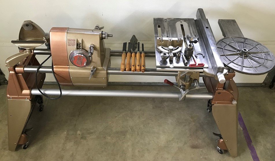

This thread seems to be jumping all over the place, but things relate back to what is on the new website and marketing. The color schemes have now been brought up and JPG commented,
Goldie is not 'historically' accurate. Original paint was closer to brown, but rustoleum hammered brown is too dark. They were also referred to as brownie. Now why was the 'copper' not involved? Rustoleum gold made a decent substitution for the brown. The original hammered look is to blame for our historically inaccurate description.
I have restored a Mark 5 Goldie in the past and now have recently bought another Mark 5 Goldie (Yuba) plus I have two Goldie Bandsaws (one Yuba and one Magna American) and a Goldie Belt Sander (still marked as Magna PTC) to restore. My only problem with the restoration is getting the right color paint to do it. JPG is correct that Goldie is inaccurate as the color is more of a light brown than the yellowish color of gold.
For my previous restoration (shown below) I used Rustoleum Hammered Finish Paint in the colors Copper and Oatmeal. The Oatmeal Rustoleum Hammered Finish Paint is a near perfect match for the Goldie paint color but is no longer available. Shopsmith used to sell a "gold" non-Hammered Finish paint but that has been discontinued too. It is interesting that they still sell the copper which is used way less in the color scheme and both dark and light green paints. The Rustoleum Hammered Finish Copper is a near perfect match too and is still available.
