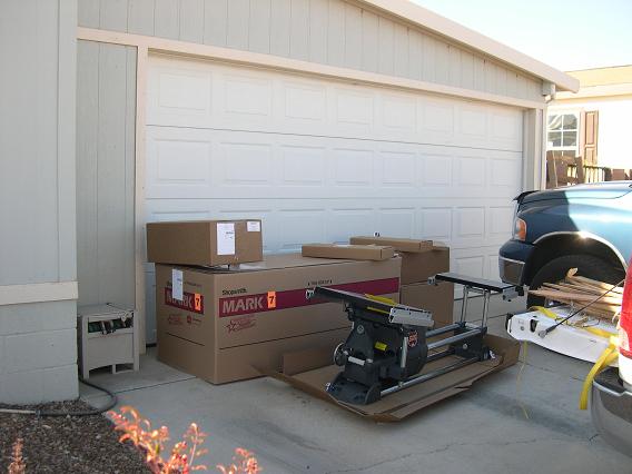

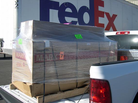

I got back home to a very cold Tucson on Sunday afternoon. (I had a previous engagement for this weekend) so I did not get too much done in the shop.
The new caster template moves the holes 1and 13/16ths inches. My garage floor may be sloped more than typical, I will have to lay out the level (as soon as I get some room) and see how much it is sloped.
I will try and add a couple of photos. Although I don't have much in the way of "Kodak moments" to post.
- Shopsmith Power pro 01.jpg (44.32 KiB) Viewed 1396 times
- Shopsmith Power pro 02.jpg (39.26 KiB) Viewed 1394 times
