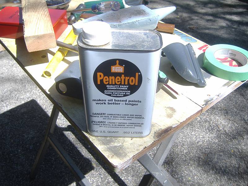

- Posts: 35428
Yes that is a good method.rlkeeney wrote:Are you saying that Penetrol will keep it from rusting or are you just prepping the casters for painting?
I really liked the idea of using a screw into wood to get the new hole in the right place. I've been trying to come up with a way to do this and never thought of the screw.
I would have set it loosely in a v-block in a drill press vise, aligned the old shaft hole to vertical by inserting the mounted drill bit into the original hole, then tightening the vise. Retract the bit and position the shaft for the new hole location.
Think the results would be close either way!:)
I believe it was from Ed in Tampa that I learned about this product and now it is my go to product for projects like this. It can be added to paint but I have never done that. I use it right out of the can per the bare metal instructions and it has worked for me.
