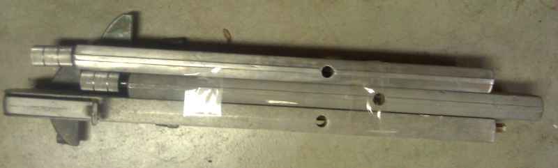

[quote="easterngray"]Thanks very much for all your replies. It looks to me like the holes for the pins on the new tubes are on a different side of the tube than the 500 pins. If so, I guess you could just drill proper size holes on the proper side of the new tubes for the 500 configuration, and replace the pins with new ones.. yes? Damagi, as to the older Mark VII tables]
as noted below - yup

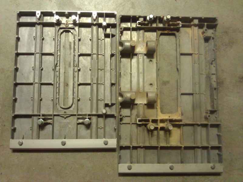

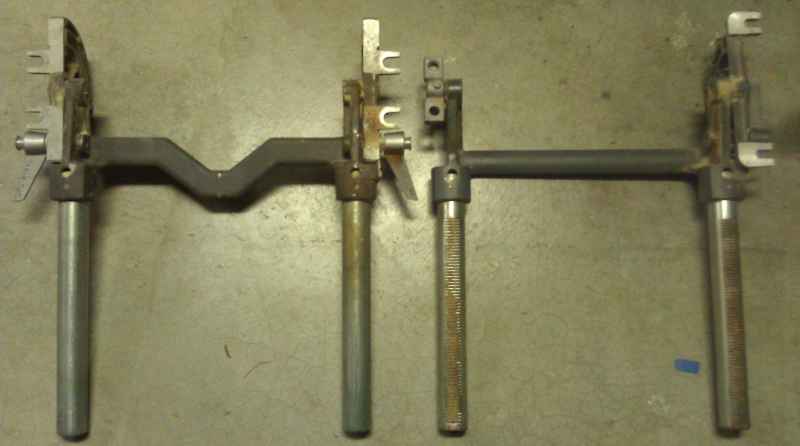

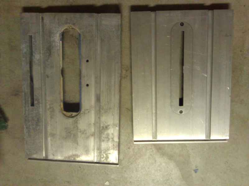

In theory you could make a bracket to adapt the mark VII trunion to a mark V table or the other way around. the rack is on the opposite side of the trunion from the mark V version, but you certainly could flip the trunion around since its essentially symmetrical.

So, do I see separate trunion lock handles on the 'front' and 'rear'?
Indeed are there ANY differences between front and rear of the trunion?
If not, reversing would be a workable method.
