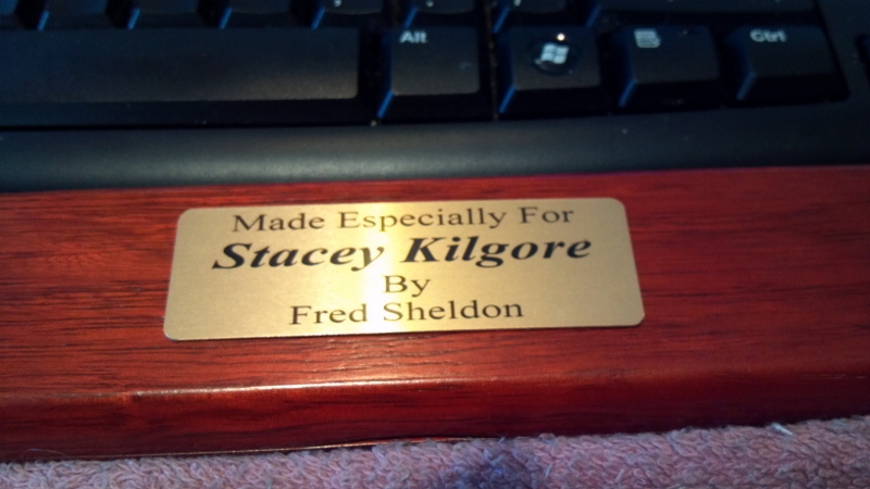

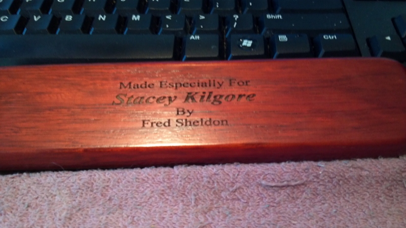

So, which do I do, engraving the wood case or sticking on a plate. Can't make up my mind. Which would you rather receive. Thanks in advance for your suggestions, I need to order 30 to be made up.JPG40504 wrote:Have you considered laser engraving the wood case instead of a plate? Woodcraft is the (a) place.

I vote for engraving the wood.
My experience is that engraved plates cost more AND eventually come unglued and fall off leaving glue residue behind. No such problems when the wood is engraved and I think it looks more elegant with the wood engraved.
Just my opinion but it's what I do for mine.

I agree that the plates might come off after many years so I'm leaning towards the engraving. I do like the contrast of the plates however.fixit wrote:I vote for engraving the wood.
Fred
