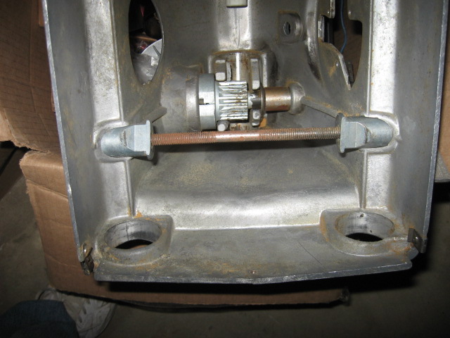

I know in the DVR upgrade DVD, Jim mentions to cut the rod if there is a problem. But is there an easier way as JPG below (above) suggests?

Oh, neither did I. It was a question. I have a few headstocks down in my basement, let me take a look. I just posted a pic. If the wedge is stripped or galled, all I can say is oh boy. It is going to be a major operation, i.e. remove the motor etc.
It looks though that the wedge could be maybe cut off with a Dremel tool, pried off & hopefully the steel thread will be okay. I hope the word lucky might be used and one of the wedges spins & allows you to get to the bad wedge....
JPG, I believe your method is the one to try. Good luck.

I normally only find one wedge that is seized to the lock rod. Remove the lock handle. I remove the motor/motor pan and then, the headstock from the way tubes. Turn the freed wedge all the way to the center of the lock rod. Then, you can remove the wedges and lock rod from the headstock. Remove the freed wedge from the lock rod. I put the center of the lock rod in a metal vise and using vise grips or a pipe wrench, attempt to remove the seized wedge from the lock rod. If successful, I find I can reuse the lock rod after cleaning the aluminum remains from the threads. This works about 90-95% of the time for me.
