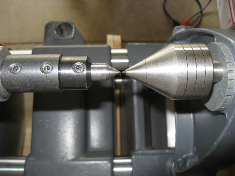

I made these out of a 1/2" body shoulder bolt. That way I had a good surface for the router chuck.
[ATTACH]18314[/ATTACH]
[ATTACH]18315[/ATTACH]
Dead center 2.JPG (83.89 KiB) Viewed 13808 times
Dead center1.JPG (98.12 KiB) Viewed 13856 times

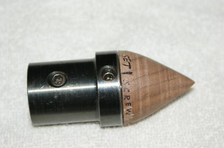

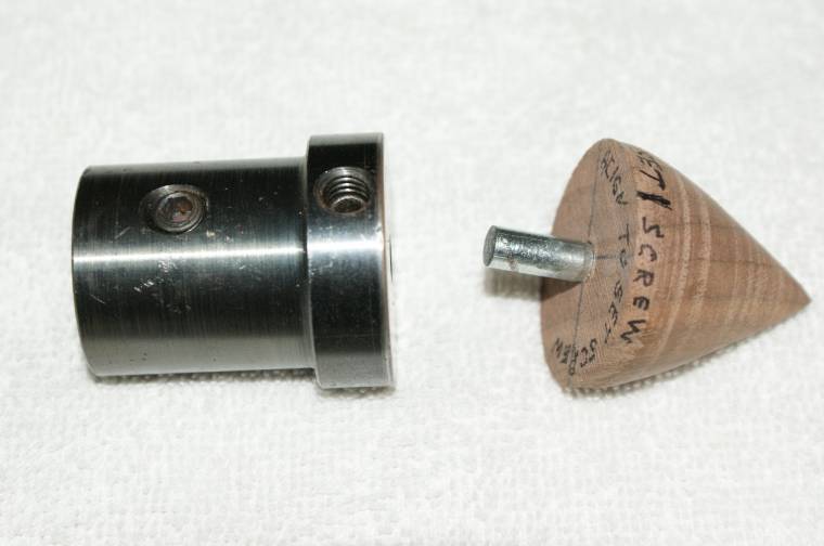

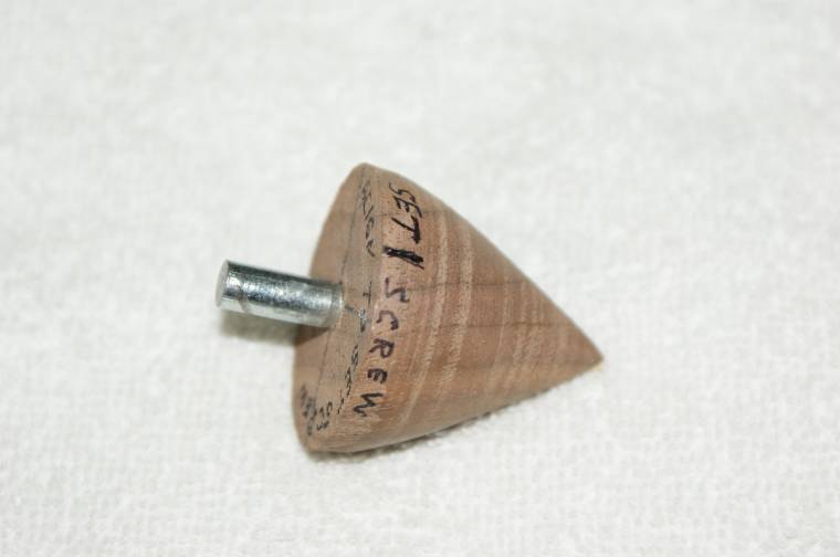

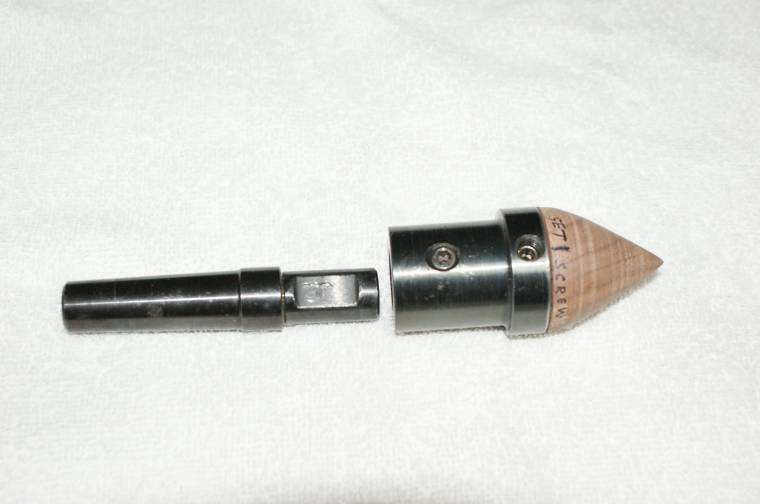

I just wanted to resurrect this thread to show that the SS screw chuck can be usedto make a dead drive center
I started by using a small scrap of walnut and a 1/4" bolt with the head cut off and threading the bolt into the walnut. This assembly was attached to the SS screw center and the walnut was turned to about a 60 deg cone.
[ATTACH]18812[/ATTACH]

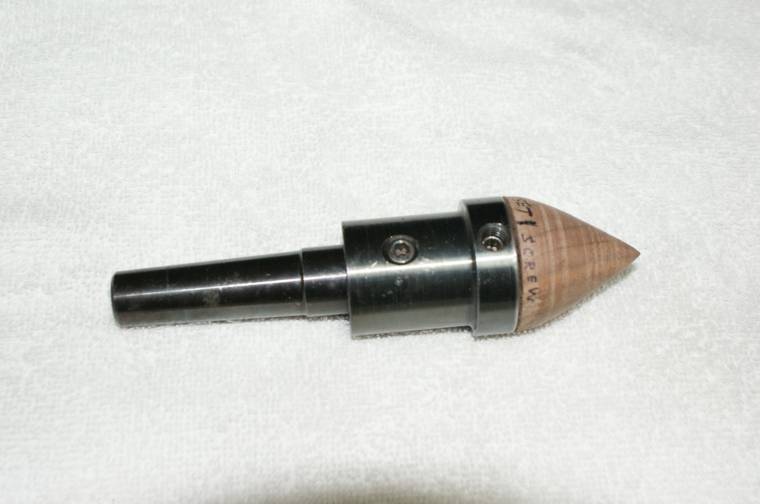

After I turned this on the SS I decided to try and use it on my Delta midi lathe so I mounted the screw center on the tailstock drill chuck adaptor and it worked really well
[ATTACH]18816[/ATTACH]
There was no detectable vibration or out of round that could be determined on either setup.
I did mark the turning so that it can be re-oriented the same way in the future.
[ATTACH]18814[/ATTACH]
One other note, while doing all of this I noticed that the standard pen mandrel is a good fit in the SS screw center. So if you don't want to use the SS drill chuck for the mandrel this chuck will do the job also.
Hope this helps someone.
dead drive center on the screw chuck.jpg (80.49 KiB) Viewed 13775 times
dead drive center.jpg (75.68 KiB) Viewed 13561 times
drive center separated.jpg (83.59 KiB) Viewed 13740 times
drive center and drill chuck #2 taper.jpg (79.98 KiB) Viewed 13558 times
drive center and #2 taper assembled.jpg (84.32 KiB) Viewed 13772 times

Not using a mandrel with bushing, how do you know when it is the right diameter to fit the pen parts?

Theonly thing that is eliminated is the mandrel shaft. The individual bushings are still used, So you still turn down to the bushing diameter
