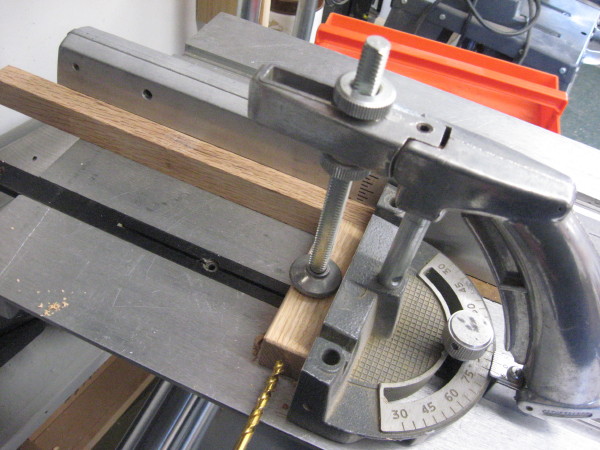

Today working on a couple of mail truck banks.
need to drill holes in each end of blanks to hold axles and wheels
they must be straight and true. set the SS to horizontal drill, install fence and used miter gauge.....straight[ATTACH]18589[/ATTACH]
[ATTACH]18590[/ATTACH] and true

Sharp bit, drill at low speed, clearing chips and debris often.
Just a tip from a pen maker who does this kind of drilling often.

Thanks OC6, pictures make things really clear. I have not yet received nor have I ever used a miter guage on a table saw - so some of the information I read goes over my head. Once I start using it things will start making sense. Just from the picture you posted I can see how this will help me in drilling an axle hole for a toy tractor that I am making. THANKS!
