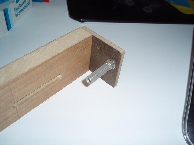

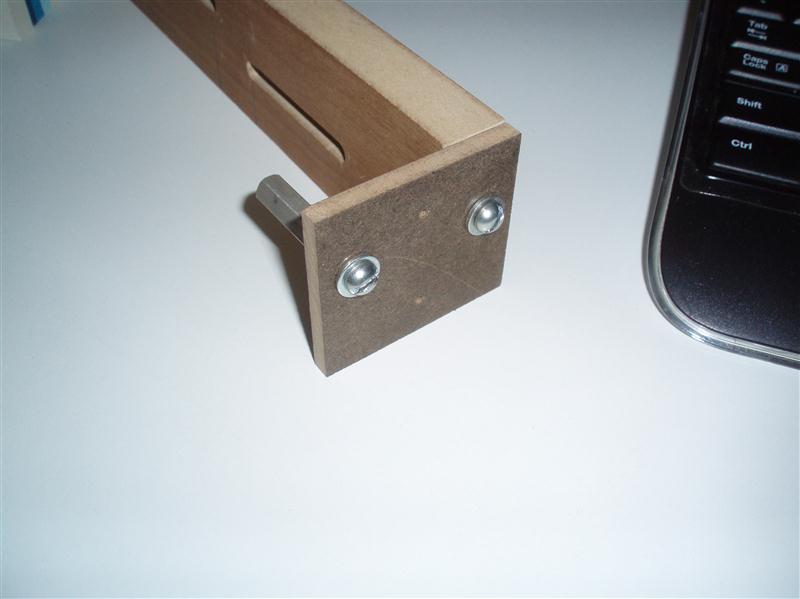

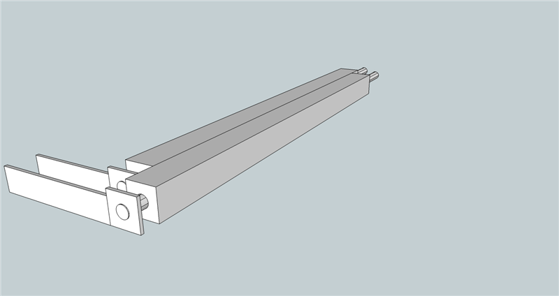

I spent a little bit of time trying to figure how the dado width and dado position adjustments will be made. As recommended, I will use 32 tpi screws so as to achieve fine adjustment. Now how to assemble all of this and with what hardware.
[ATTACH]19767[/ATTACH]
I came up with this:
[ATTACH]19768[/ATTACH]
[ATTACH]19769[/ATTACH]
I need to replace the screws with a user friendly head (knob) but I'll have to shop for those. These flat head screws will do for now. The threaded inserts will be epoxied into their respective holes.
Adjustment Assembly (Custom).png (75.98 KiB) Viewed 3223 times

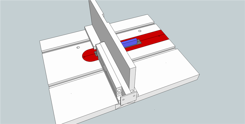

OKAY, you got me to thinking about this. It is terribly unfair of you to plant a seed like that when I am trying to close out another pipe dream.
[ATTACH]19838[/ATTACH]
Threaded rod permanently attached to "the fingers" and positioned by the square tubes. Knobs missing. I haven't learned how to create knobs yet. I'm thinking JBWeld to attach the fingers to the rods along with nuts embedded in each end of the square tubes with JBWeld.

heathicus
Posts: 2648
Location: WhoDat Nation
Post by heathicus »
What will keep the fingers from rotating with the rod?
Heath
Central Louisiana
heathicus wrote:What will keep the fingers from rotating with the rod?
Nothing! That's a concept error on my part.
To solve that, I'll have to have something at the other ends of the rods that positions them without rotating them.
Another, quicker solution would be to buy the Incra Jig.:rolleyes:
Thanks for the feed back.

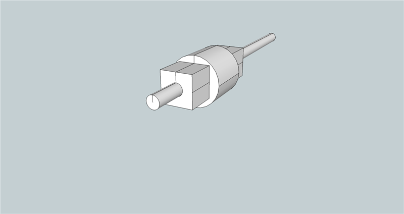

My first thoughts about a solution.
[ATTACH]19839[/ATTACH]
The cylinder is threaded on the inside (think pipe nipple) and the threaded rod is threaded through it. The two cubes capture the cylinder so that it does not move the length of the rod. When it is turned, the rod moves back and forth inside of it.
