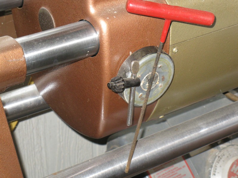

Finally got signed in to the correct Flickr account.... here is how I store my key...
Thanks
Geo
chuck key storage 1 by EagleTa2, on Flickr
chuck key storage 2 by EagleTa2, on Flickr
Thanks
Geo

Here is my solution. I love it and I am going to apply it across the board as soon as I get enough speaker magnets. I also have about a 3 inch one on the drill press in the farm shop that holds the key and about 3 center-drill bits. I also have about a 4" one attached to a 30" piece of broom handle that is invaluable for picking up dropped items especially if you drop something in grass or gravel.
[ATTACH]19734[/ATTACH]
