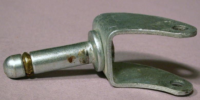

OK, the caster sage continues, the dremel grinder worked best. Less then one minute and the rivet was virtually gone. One hit with a center punch and it was apart. Now the question, in the photos below you will see the support arms are not parallel and both arms are not perpendicular the the crossbar. Is this normal or do I need to do some metal bending before replacing the wheels?
[ATTACH]957[/ATTACH]
In the picture notice the support arms are flat with the table but the stud also touches the table.

[quote="paulmcohen"]OK, the caster sage continues, the dremel grinder worked best. Less then one minute and the rivet was virtually gone. One hit with a center punch and it was apart. Now the question, in the photos below you will see the support arms are not parallel and both arms are not perpendicular the the crossbar. Is this normal or do I need to do some metal bending before replacing the wheels?
Paul,
In that I have put my $.02 worth into this subject earlier in the thread I will continue with the cheap advice. The sides of the caster should be parallel with the stem of the caster. The sides can get bent for a multitude of reasons so just whack them parallel or use what ever method achieves this for you and assemble the wheels. Keep in mind that the steel bushing must fit in the same place as the original axle. Do post a pic of the finished caster.
