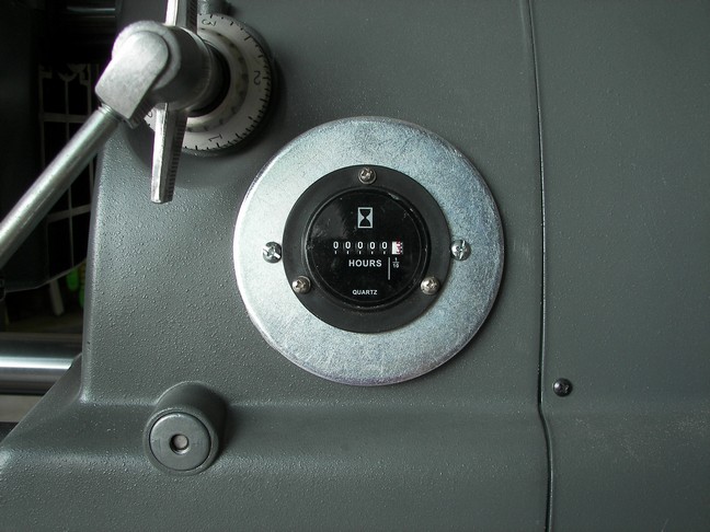

Shopsmith Hour Meter
Many years ago, I fitted a round 2" 110 VAC hour meter into a a large 4 1/2" round plate and mounted it in place of the LOGO cover. I used 2 short arms and screws to hold it in place. I connected the 2 meter wires to the motor power wires with a clamp-on connectors. I offered this item on Ebay for a few months with no sales. I may still have a couple of these hour meters floating around somewhere, however I have not seen them in years. Contact me for information if anyone would be interested.

Mayo Meter
Just installed my hour meter (Mayo Meter). Now, to put some hours on it!billmayo wrote:Many years ago, I fitted a round 2" 110 VAC hour meter into a a large 4 1/2" round plate and mounted it in place of the LOGO cover. I used 2 short arms and screws to hold it in place. I connected the 2 meter wires to the motor power wires with a clamp-on connectors. I offered this item on Ebay for a few months with no sales. I may still have a couple of these hour meters floating around somewhere, however I have not seen them in years. Contact me for information if anyone would be interested.
