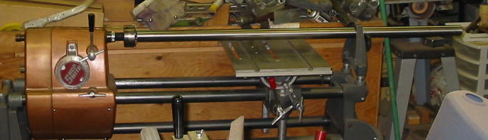

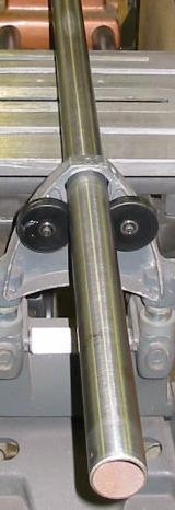

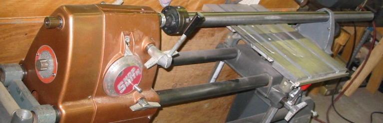

I use the Shopsmith to clean and shine the tubes. I brought a Mini lathe chuck ($30 on Ebay) with a 5/8" hole in the mounting plate. I used .002 shim to tightly fit it on the 5/8" molder/dado arbor and used a dial indicator to make sure the chuck was centered on the arbor. I tighten the nut then and had the mounting plate welded onto the arbor. I cut off the arbor shaft even with the front of the mounting plate with it mounted on the Shopsmith and a hack saw.

I find that I use the lathe chuck for other tasks. I made slotted mounting holes for the rubber wheels so I could center whatever I was spinning.
