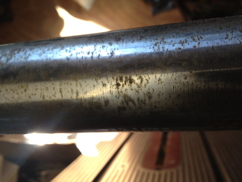

removing rust on tubes
So from what i am seeing is that it is great for removiing light rust from way tubes etc:
I recently picked up a complete MK V 510 from a storage unit that has been stred for many years " date code 12-11-04 " with some rust on tubes.
- rust1.jpg (63.19 KiB) Viewed 6396 times
