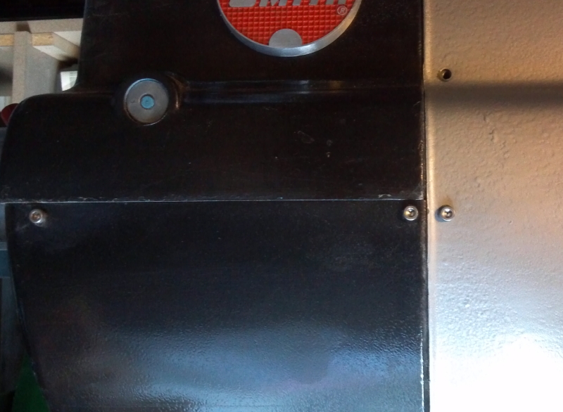

Update. Modifications complete
I had some time this weekend and knocked this out.
I removed the belt cover and motor pan, then cleaned the inside of the head stock where the holes and are nuts will be glued down with JB Weld

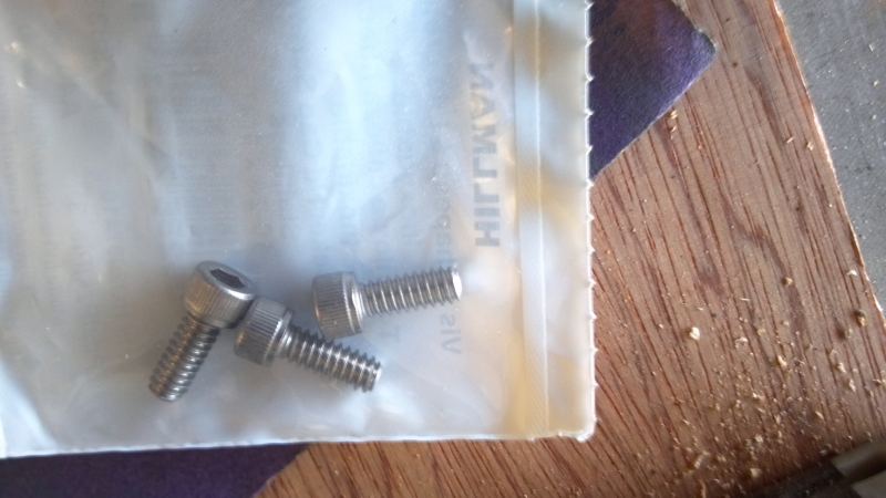

I decided to use these screws. I thought it would be handy to be able to use my 5/32 hex key to remove the belt cover and motor pan
[ATTACH]20786[/ATTACH][ATTACH]20787[/ATTACH]

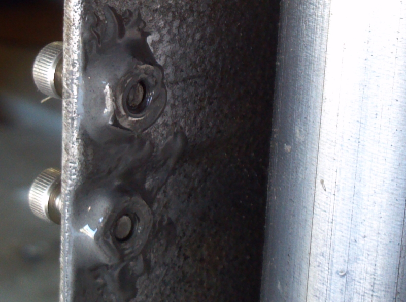

Mixed up some JB Weld and adhered the matching nuts to the inside of the belt head stock.
[ATTACH]20788[/ATTACH]

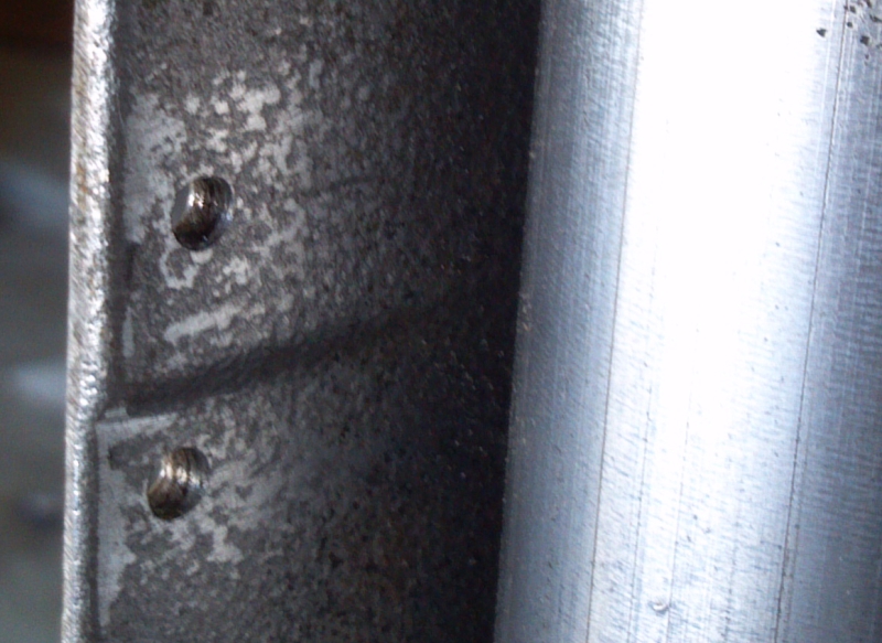

Performed a cleaning and lube while I had everything open. Waited over night for the epoxy to cure, and fastened everything back down.
[ATTACH]20789[/ATTACH]
[ATTACH]20785[/ATTACH]
